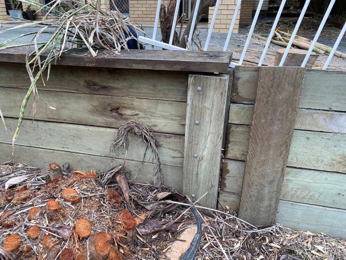

My main concern is the structural integrity of the timber. While most of it appears to me to be in okay condition for it's age (assuming 20 years+), there are portions that appear to be water affected (no surprise). Furthermore, I would be super grateful for ideas the best form of restoration (wood staining, oil, etc) or replacement (timber, concrete, etc)

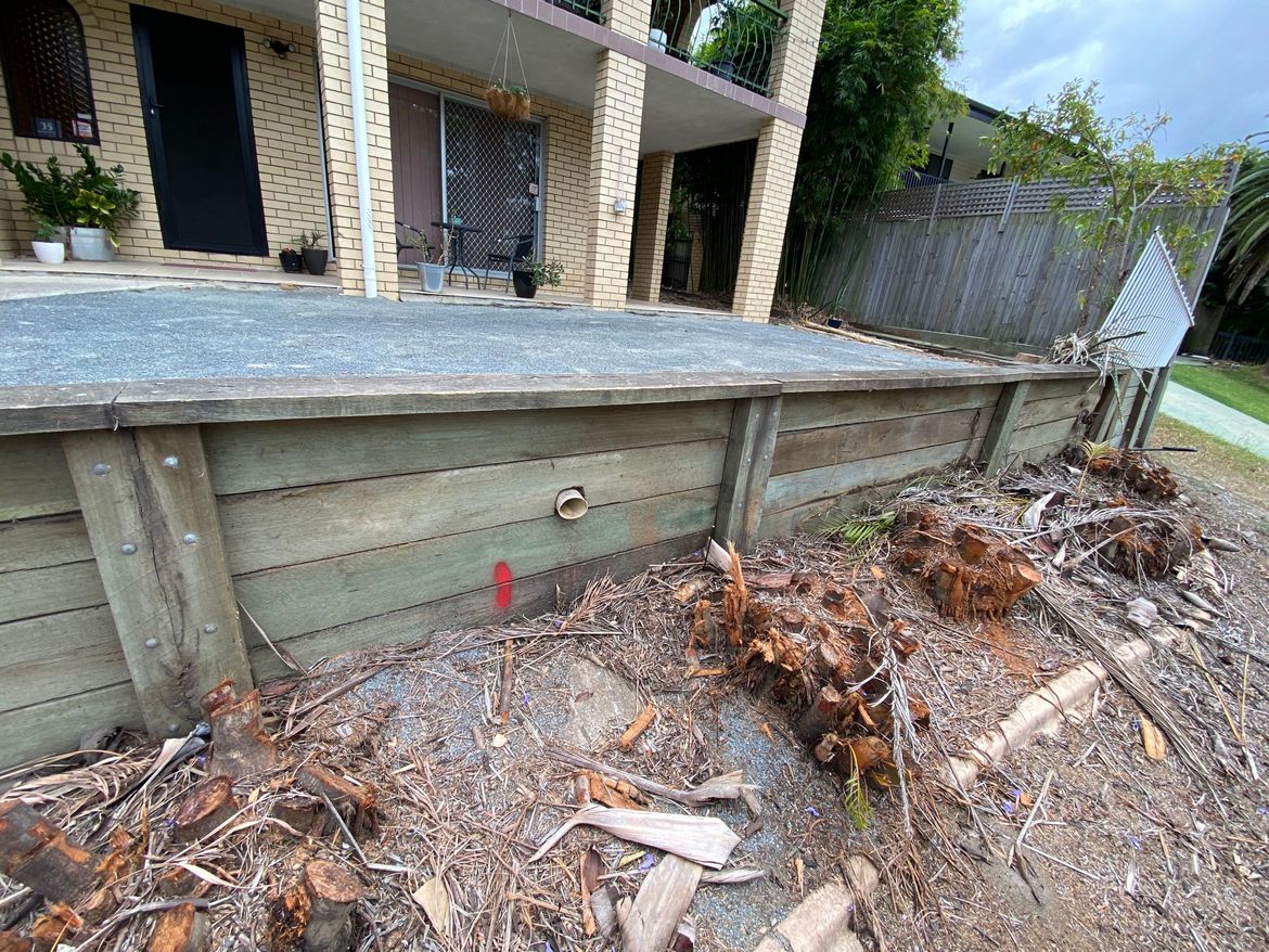

Thank you!Overview of retaining wall with Storm water drain through

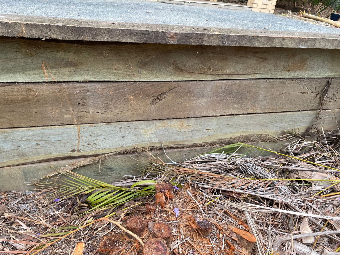

Peeling of timber at the bottom of some planks

Your retaining wall looks to be in pretty good nick, Not sure if there is any lean to it from the first photo or if its just the angle of the photo itself.
If ther wall is vertical then Id say leave it as is. That last panel with the white pool fence on top dosnt look as well supported but still looks solid.
Overall Id say its a nice look retaining wall ![]()
I think I see the root through the wall. Id just chop it off flush with the wall. The dampness looks like some recent rain/watering or washing the car even as its only coming through at that point and dosnt look like its been there long term. (keep an eye on it for sure but think of if its been raining recently)
I am unsure on how to repaint it or if it can be restained as its copper logs type colour for tpouching the ground. I like the look of it and apart from maybe replacing/fixing that topmost cover plate all the way along I dont think id do anything.
With that pipe out of the wall is that to a drain on the driveay above? Maybe check to make sure its clear all the way through.

Congratulations on your new home. It's great that you've received excellent advice from @Dave-1. Looking at the photos you've posted it seems like the timber is still in good condition as there are no deterioration spots or large cracks that would compromise its stability. It is the last post that concerns me, but it looks like it was moved out of place due to tree roots rather than natural settling.
If you are worried about the holding post, I suggest digging down to its concrete base and see if the post has cracked or the concrete footing has split. If it has, it will need to be replaced so that the retaining wall is not compromised.

@Dave-1 the pipe through the wall is the storm water drain and seems to be working just fine, no leaks or clogs. The palm tree stumps are a killers, especially because I may or may not have underground electric and water lines going around the area, rip.
