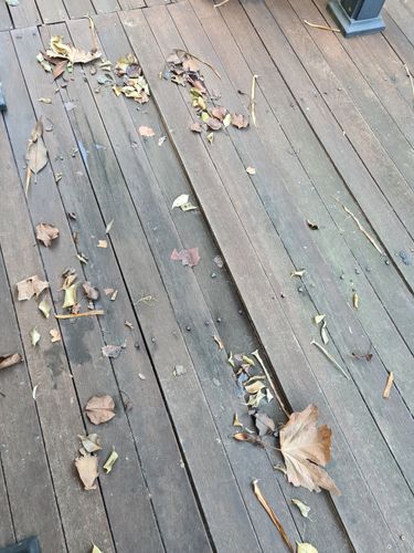

Given the popularity of decks and DIYing them here on Workshop I thought it's important to show the perils of not installing them correctly.
In all my responses to people (and obviously the decks I build) I advise to use;
  • H3 timber with a 250mm clearance between it and the ground because it can't be in constant contact with moisture
  • H4/H5 timber for posts/stumps, the outer frame and anywhere else there isn't sufficient clearance causing the timber to be in constant contact with sand, concrete, etc and ultimately moisture.

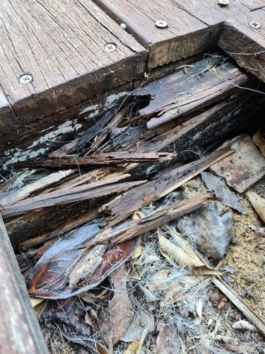

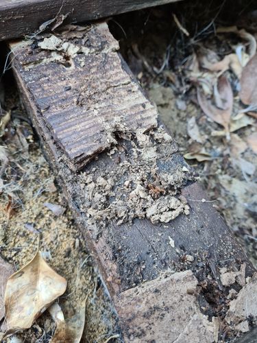

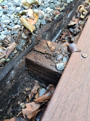

Below are the results of not following this advice. Someone installed this deck with no clearance - H3 sitting on the sand below. This deck was installed about 6-7 years ago and is beyond repair.
Decking boards are sinking. I can pull them up with just my fingers. Pressing on the rotting frame causes it to crumble away. It's become very dangerous.
