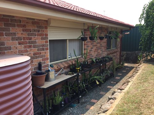

I need to add/ attach shade cloth from the house to retaining wall.

I would like a permanent shade hose type of construction to shade my plants

@Former Workshop member
Thinking is shade cloth classed as a roof?
If you have no permit issues then you have some choices.
PVC pressure pipe, cheap will allow for curves to be made and I think you can get clips for shade cloth for pipes on the downside the pipes can sag on long runs.
Galv water pipe less likely to sag but hard to curve and to put together.
Metal tube with plastic connectors, easier than water pipe to make but the weak point is the plastic joiners.
Shade sail with post and rail/s might be the best looking option but likely the most expensive and you have limited choices on size of the sail unless you go custom made.
Welded frame I could but it is summer so why would I want to?
I would opt to leave the ends open if it is just shade you want and not a green house effect, given the slope on the wall and it's construction it would be hard to make neat looking ends.
Bit late but I hope it helps
