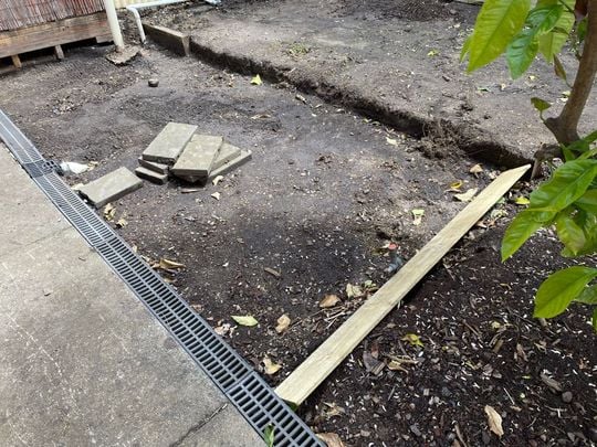

Hi, I'm doing makeover my backyard, it had some grass area in the yard which is higher than my garden bed. My plan is to get rid of old grass and garden bed, leveling up and put new turf (Buffalo).
Lots of digging are nearly done. My next step is to work out what material should I use to backfill old garden bed areas to level up with old grass area. I've been considering road base to level, then 100mm lawn mix underlay on top, then the turf. I went to nearby nursery and they suggest using soil fill for backfill the old garden bed instead of road base. And if I use Soil fill material, do I need to compact the ground using compactor?
I hope someone can help. Really appreciate it.

I suggest using soil fill and running the compactor over it. The reasoning behind it is if you were to place the soil in as is, it would naturally self compact at a much slower rate. By then, it'll be too late to fix the problem as one side will be lower than the other. By compacting it at the onset, you'll have the correct level of soil even after heavy rains. Please be mindful of the slope of your garden. Your objective is to make sure that the soil is sloped away from the house so that water flows away and does not pool in the middle.
Once the soil is level with the other side I suggest using Saxon Lawn Aerator Spiked Roller. Please make sure to use this on your entire garden and not just the compacted soil. This will allow water and nutrients to be absorbed, encouraging deeper root growth for your turf. If the soil is compacted too much the turf roots will not be able to penetrate the soil and they will die off. It sounds like a fantastic upgrade for your garden. Any updates you can provide while laying your turf would be much appreciated.
My number one tip for your project is to make sure that the area is prepared to receive the new turf as soon as it arrives. In this manner, the turf will encounter minimal stress and you will have faster turf growth.

Can I ask another question, it's more for my knowledge. From what I learned from the nursery that soil filll is used for backfill only, and they suggest once levelled, having another at least 100mm of lawn mix on top for new turf, so I wonder what's the difference between soil fill and lawn mix?

The main difference between the two is that lawn mix has additives in it. Let's take a quick look at the steps you need to take. If you're filling in a gap of 150mm for example, what are some of the things that you need to take into account? First is the thickness of the turf, the average thickness of turf is 40mm. You'll need to take that measurement off the gap. You're now left with 110mm. If you were to fill 100mm of the gap with garden soil that will leave you with a space of 10mm for the lawn mix.
