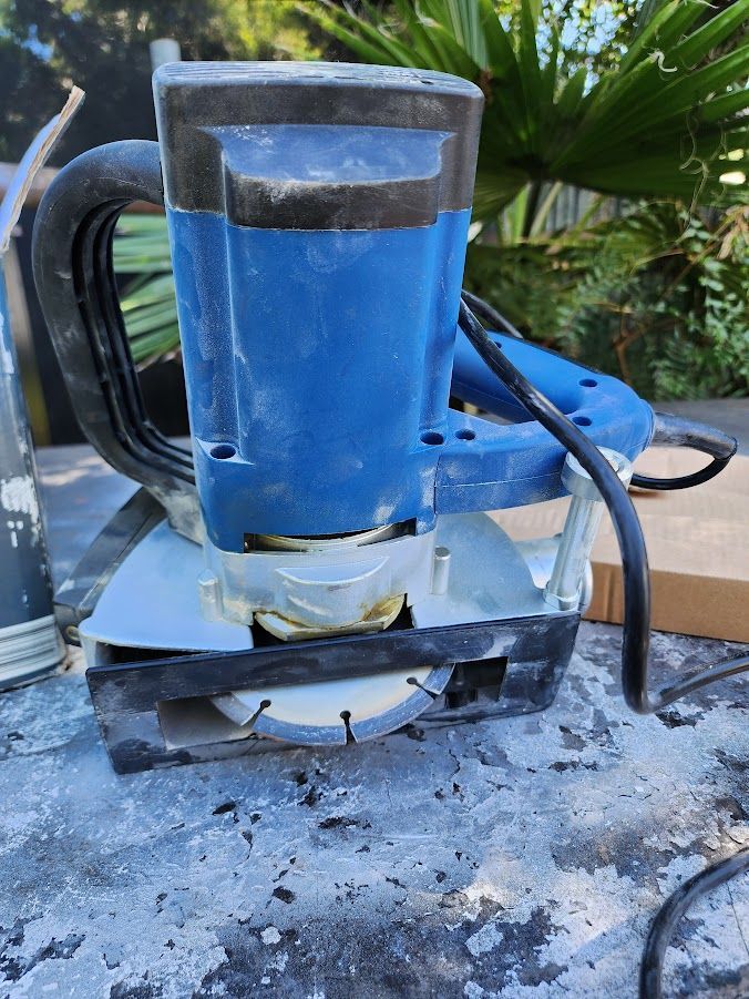

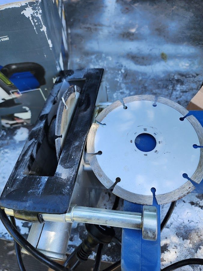

This is just an amateur's experience. But 15 years ago I wanted to cut a 4" X 24" piece from a concrete sheet (15 mm thick).
By chance, a 'supermarket' had on clearance ($50) a wall chaser.
With the supplied spacers you could reduce it to one blade - 125 mm diameter with 1,700 watts (2.5 HP)
I thought it was gonna cut the concrete sheet like a hot knife through butter.
In the end it would been faster to cut with a butter knife.
I can't explain the physics - but the machine was hopelessly inadequate.
Hence my thought is to seriously reconsider that 7" cutter attached to your, what is essentially, a wood saw.
Instead, go with the brick saw mentioned above.
Cheers.
