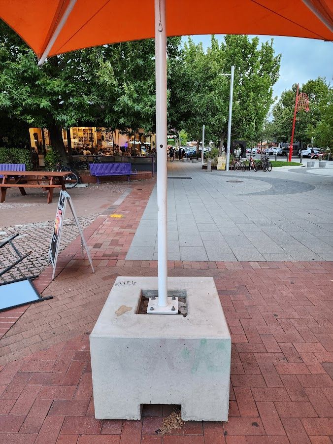

Re: What size base for a 4m round market umbrella?
I saw this in Canberra recently.
Very windy day - note one of the restaurant boards bowled over.
This base withstood it all. But no wheels.
