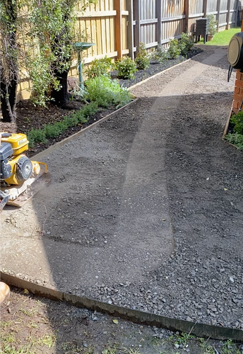

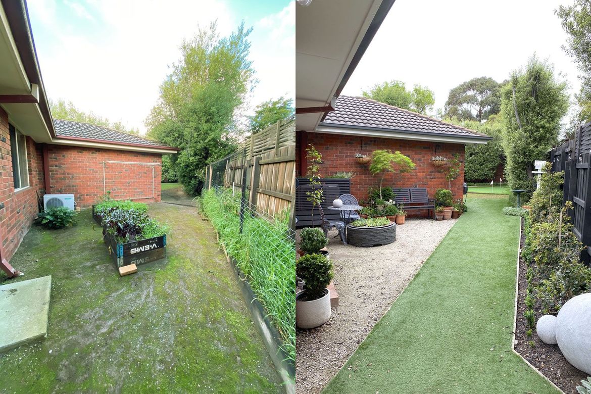

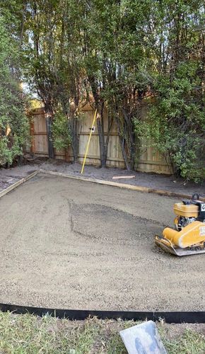

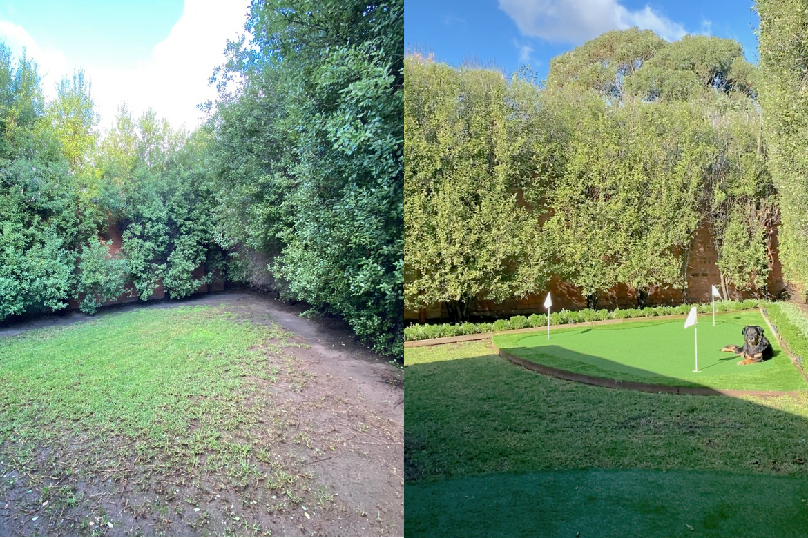

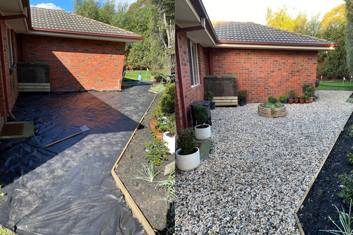

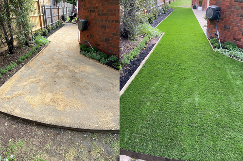

Welcome to Bunnings Workshop community! We’ve laid a couple of areas of synthetic turf in our backyard (DIY backyard golf putting green & Tidying up an odd-shaped area in the backyard) and this was our method:
Hope this is helpful in your artificial turf install! 😊
Hi @danil22
I believe @homeinmelbourne's in depth recommendation has covered all the bases regarding ground preparation for artificial turf. Their putting green setup is immaculate. I propose visiting your local store and speaking to the special orders desk in regards to ordering crushed rock, road base and sand. While you are at the store, I also suggest having a look at the compactor for hire.
