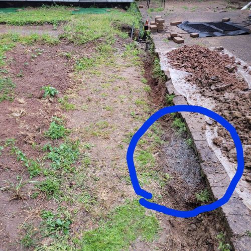

we have a few large chunk of concrete left by previous owner buried underground and our rotary hammer is simply not powerful enough

2)We have digged out a lot of clay soil with rocks and are planning to backfill the trench with better soil after the pipe installation
