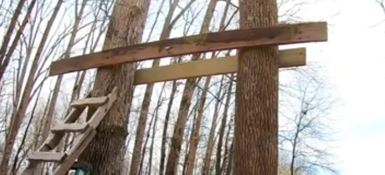

I am thinking to build a tree house with my kids. With absolutely no idea what to do, so I searched up YouTube trying to learn to build. Sadly, none of these tutorials taught me what tools and materials to buy.
The first step is to attach the timber on to the tree, like the picture below. But what kind of screws and what type of timber to buy? Can someone guide me through please?
There will be a lot of questions during the entire project but seems I am already stuck at the very beginning. ![]()

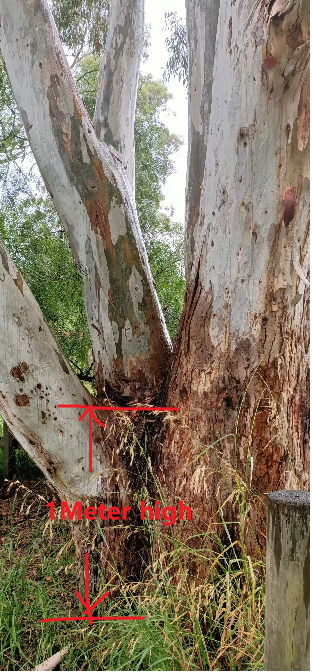

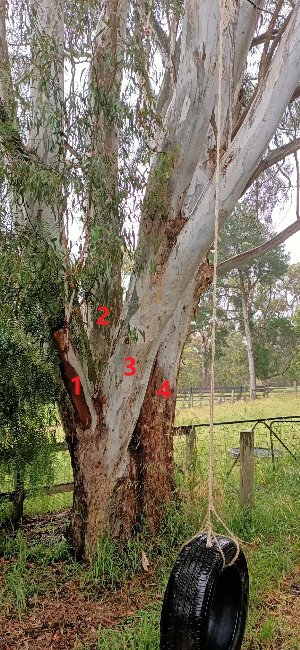

This is the tree I am planning working on. It is a gumtree.
There are 4 big branches which spread from 1 meter high.
Hi Jerry,
Looks like an ideal & sturdy candidate ! some issues you won't have to deal with as it's a single tree; but the individual branches may still move independently, and grow over time; so attaching a solid frame between them may cause problems. I'd still look at putting individual pegs (I used high tensile M26 thread) on each branch (use a laser level or trusty length of hose with water in to get all your levels correct; and build the main platform resting on pegs like a floating platform. you could go more grandiose and have a 2nd platform where that centre trunk branches further up ! ![]()
in addition to the pegs that the platform can rest on, you can run hip braces from the outer edges back at 90o to the bottom trunk for more support on the edges. look forward to your progress ![]()

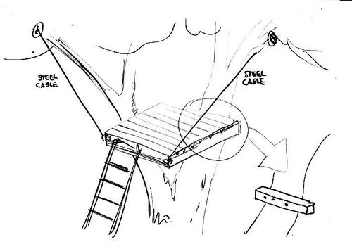

Thank you for posting the picture of your tree. Now we know what it looks like, it's time to think about the shape of the tree house and how big you want to build it. I suggest drawing out a rough design of how you want the house to look. Will you be doing a four-sided or a five-sided house? Will adults be sitting in the tree house or is it just for children? I'll be sketching up a design as well and once I've finished it, I'll post it here for you to have a look at.

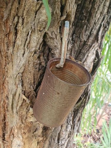

"I dont want too poop the party but will screwing into the tree kill the tree. or ? "
Good question - I have seen nails, bolts, screws and wires embedded in some of my trees that have been there for over thirty years. In my case I knew once the 'thrill' of the flying fox was over, the large screws could be easily removed.
I think this is thirty years old in a Eucalyptus...
