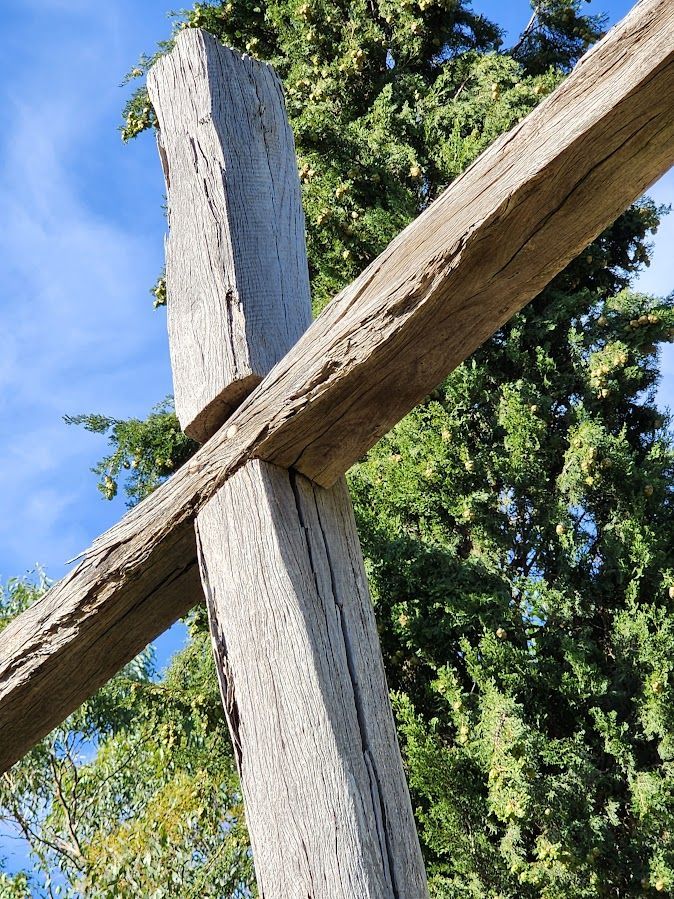

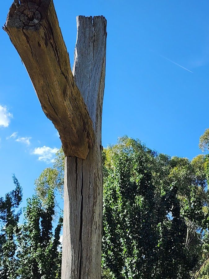

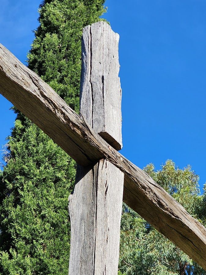

Evening @PDTeam

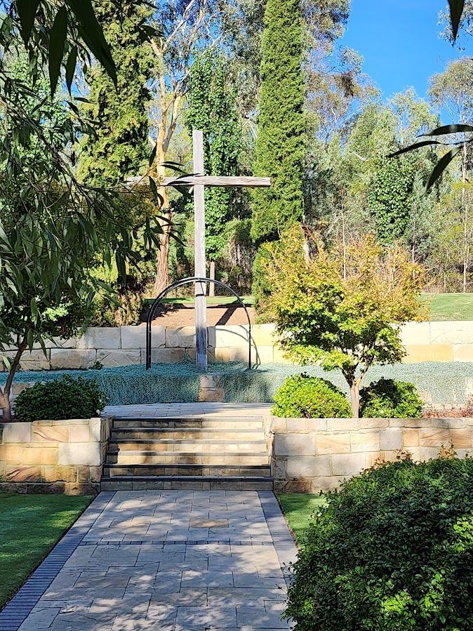

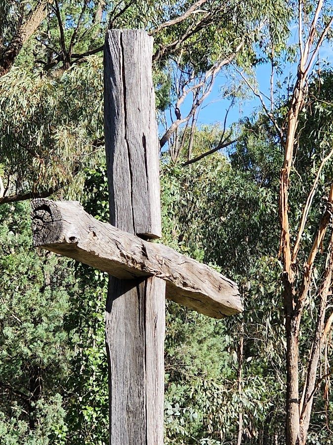

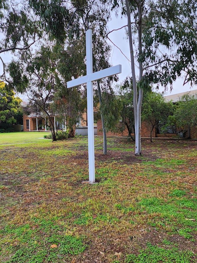

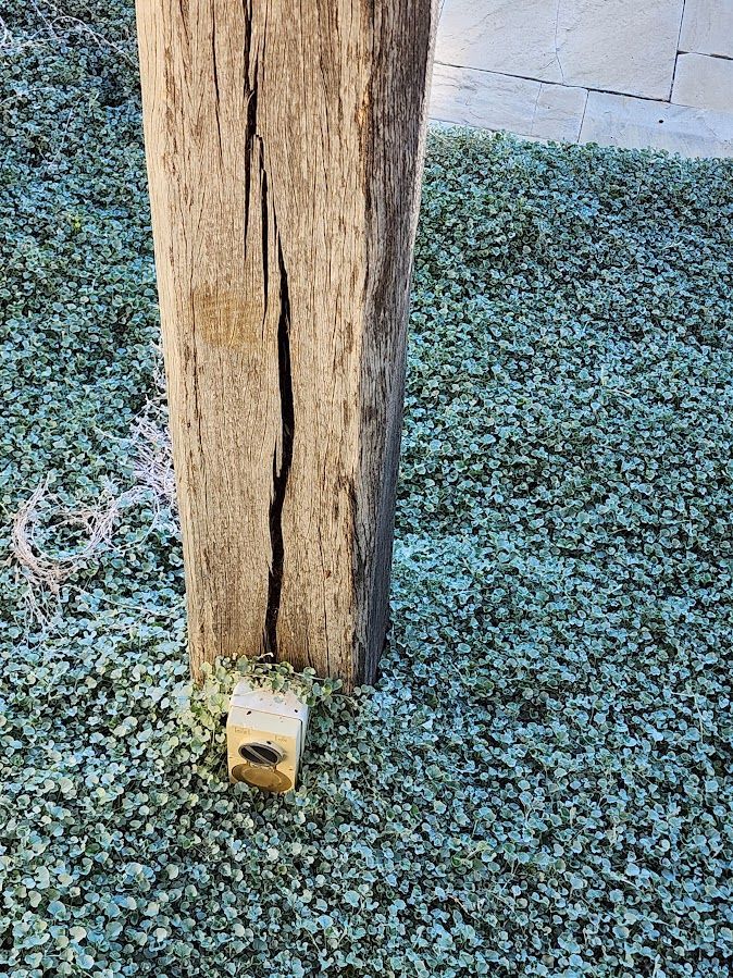

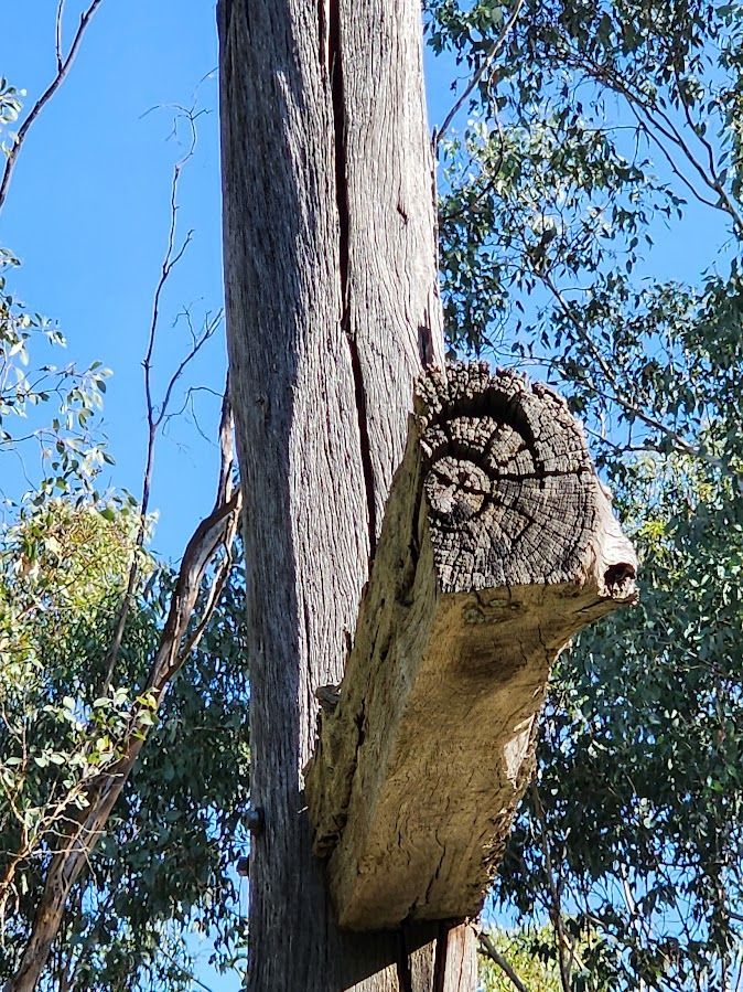

You may have already decided on your design and wood type, but my immediate thought was old hardwood beams of even very large dead tree trunks/branches.
Someone in your congregation may have access to this type of wood and/or a good chainsaw.
My thought - the more rustic the better.
You never mentioned size - but here's an example of what I was thinking of - this is a local tree chapel...

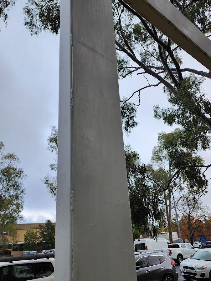

Crucifix Design - Part Two.
I 'bumped' into this one the other day. Steel channel with plate spot welded on the back - small light at top.
Well anchored but very wobbly when shaken. Hopefully nobody filmed me.

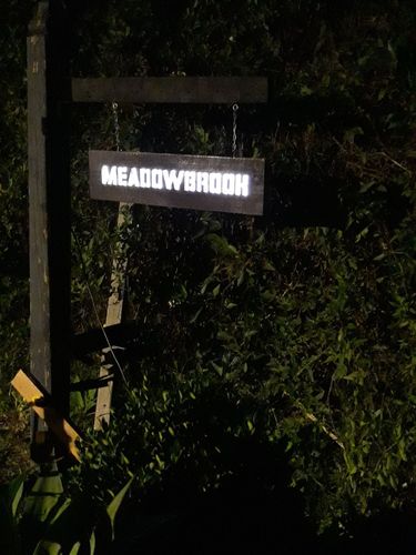

Hi PDTeam,
Here are some more ideas, random photos of one of my prototypes for a country property sign with LED solar lighting.
I made one for a rural religious group and the word got around.
Build photos.
I also made skinny versions of that as crosses for the above mentioned rural religious groups and communities.
