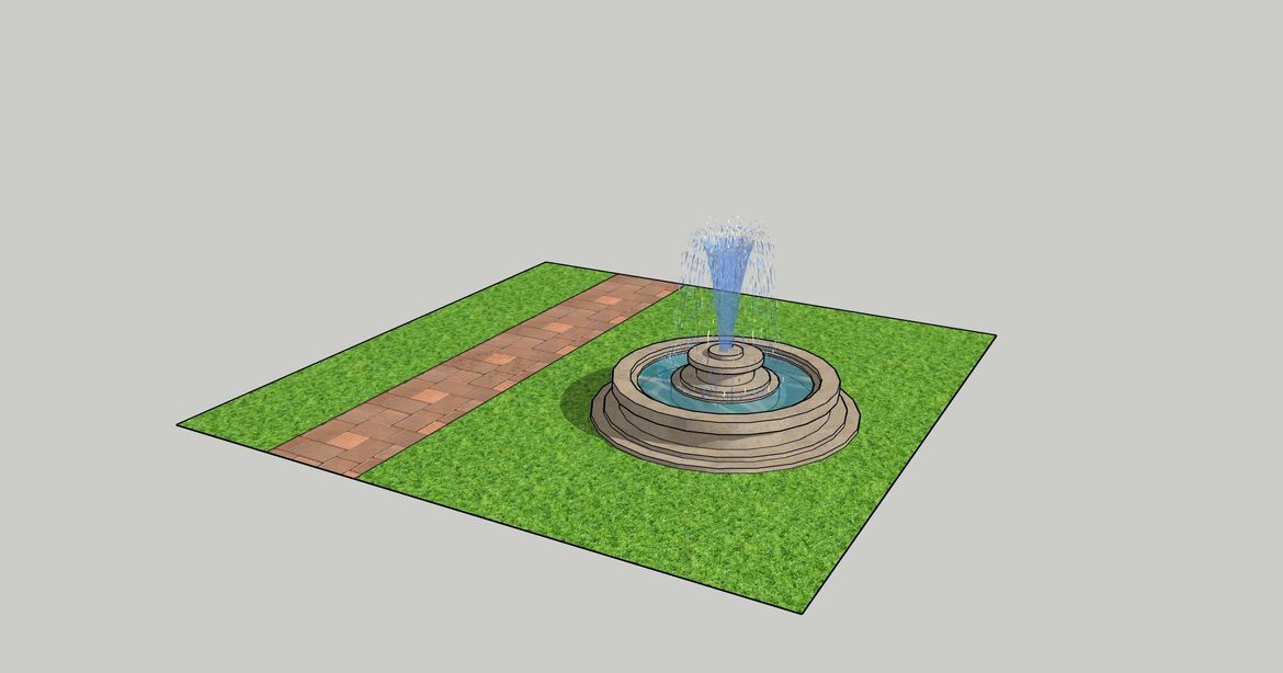

Is the path regularly used from the front gate to the house? If you notice that this is the most common path that everyone in the family uses you have 2 choices. The first choice is to line the path with pavers to make it an official path. Everyone is using it and that's why it gets worn down. The second choice is to create a totally new path with pavers away from the old path. You can start training everyone to use that path instead of wearing down your beautiful Sir Walter Turf.
However, as we all know humans always prefer to take the shortest distance between two points. You may have to be extra vigilant to make sure everyone is using the new path and not walking on the turf. Having a path is necessary at least with a paved pathway the rest of the turf will not get worn down.

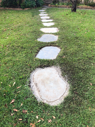

Hi @JulieL,
We had a similar problem at our house and used bluestone rounds to create a path. Very easy and we think it looks great. Compared to the photo below, the grass has since grown to the edges of the rounds so they look like they were always there.

Thank you for this and the photo.  It looks so good.  This is probably my best option.  Trouble is, I am a widow and too old to lay pavers myself and finding any sort of handy person to do this these days is just about impossible. The  grass actually  is fine in summer when it’s growing.  But when we get wet weather in winter, and the grass gets trodden down  it wears away to mud and of course the grass doesn’t grow back at that time,  so was also looking at maybe putting down some sort of protective matting or runner.

Hi again @JulieL,
I would recommend you try a site like Hipages or Airtasker to find a tradesperson who could assist you. We just used paving sand for the base of the bluestone rounds as they are big and heavy and not going to move. So it is a relatively quick and simple job.

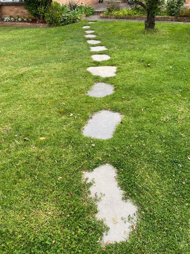

Just wondering if you've made any progress or need a hand?
I took this shot today of how the bluestone rounds look now.
