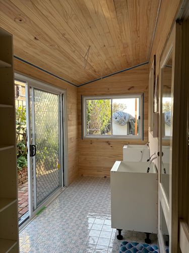

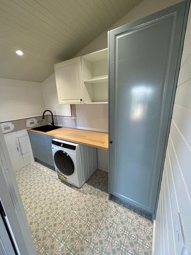

And lastly reversible pine lining boards, these can be nailed in with an 18Ga brad nailer and 35mm length brads. I've been working on a couple of laundry makeover jobs and these were used flat side for the walls and channeled for the roof. It's available both primed and unprimed. Very easy to install.
