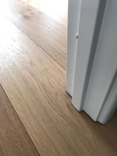

@ProjectPete that looks fantastic, as I thought I was not familiar with how that fits into the steel jamb. I saw the word "bottom" and took it to mean literally the bottom rail of the jamb. Couldn't invisige how that would work.
Do you just free hand that straight line, or did you make some jig for it @ProjectPete ?

@MitchellM
- Place your floorboard against the doorframe (including the underlay of its separate to board) and mark a fine pencil line around the whole door frame.
- Cut the frame out with your angle grinder following the line precisely.
- Using a chisel, jimmy the bottom section out enough to cut it so its in two sections allowing you to grab it with pliers.
- Wiggle back and forth until each piece snaps off (it's not too hard as they're only 5-12mm depending on you boards).
- Using a multitool with a diamond bit, "grind" out the cement from under/within the frame. The more you get out, the better as it'll give you more room to fit your floorboard under.
In every case - think safe, work safe. Grinders are hard to handle, especially at this angle and working on a jagged door frame.
It's not easy to do, but gives the best finish.
If you're in Perth I'm happy to show you.
You can cut the frame with a multitool which will be safer bit take longer and you'll probably go through more blades than grinder discs as the steel frame is quite thick.
I'll take photos/video next time I do it and share it.
