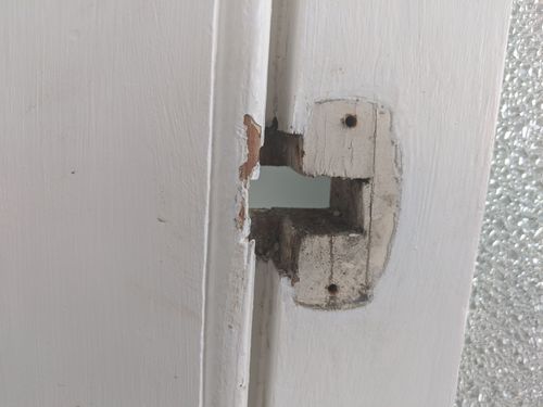

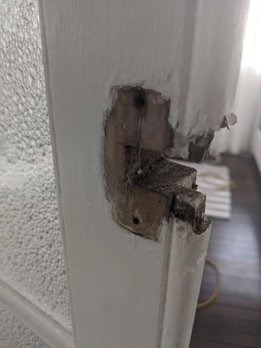

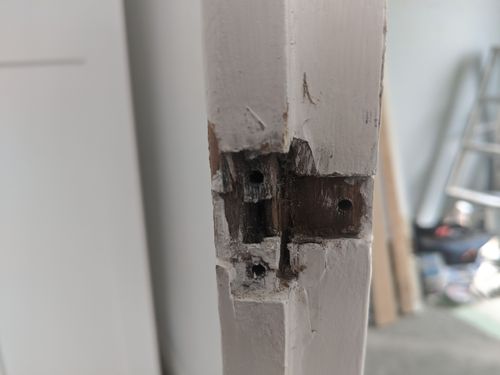

Currently renovating our ensuite and installing secondhand french doors.
They came without a latch, so I'm trying to figure out what type of latch could work in the space. Large block out on one side and minor rebate on the other.

@silver_pear A tear drop latch would do the job perfectly, Bunnings do sell them but i cant find one on the website

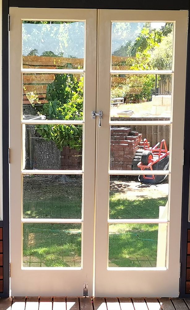

this is a pic of some doors i restored you can see the latch on there
https://www.tradco.com.au/products/locks-latches-and-hinges/french-door-fasteners
Not sure on the rebates though.

As @wooshka and @Brad mentioned, a tear drop-latch would suit the doors. In order to use a different type of latch or lock, you may need to fill the current cut-out in the door with some Builders Bog. I would recommend this over other products as it can be sanded, drilled, painted and is perfect if you need to install the new latch over the filled area.
Our step-by-step guides on How to mix builder's bog and How to install a door handle might be helpful to you. I have also attached the videos below. They show the mixing method for the filler and also the installation of a new locking mechanism. Please be advised the door handle guide depicts a standard internal door, but the methods used will be the same for your project.
