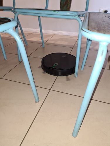

It gets inbetween chairs fine and under our cabinets

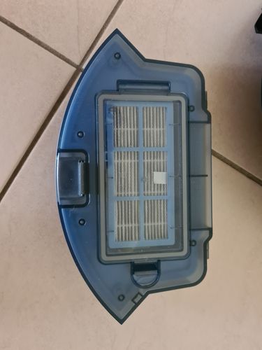

Requires empty of tank every second day for us

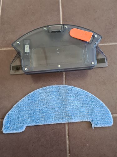

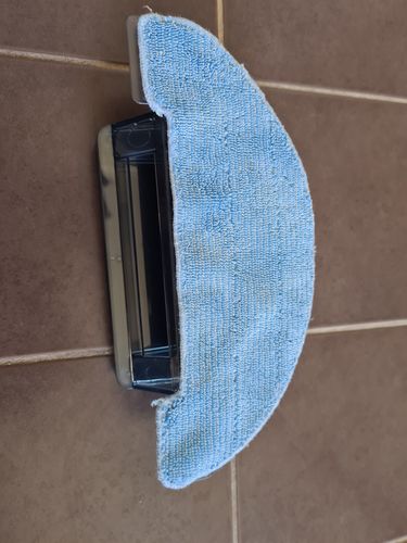

It has a separate mop tank with 2 mop pads, I used 70 deg water and its moped fine but don't expect the same as a steam mop or hand mop it's only dragging a wet rag over the tiles

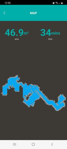

You can view the area it has been for the day.

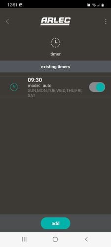

I have it scheduled to cleaned once a day in the morning at 9.30 7 days a week unless I want a sleep in then I will turn it off as I have to shut the bedroom doors and pick up anything I don't want sucked up. It takes a good 4hrs to recharge back up before ready for another use.

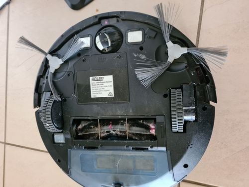

Having a look a the product manual and it suggests that three beeps with a red flashing light indicate a drop sensor error. The solution would be to clean the drop sensors underneath the robot and place it on a flat, stable surface. If it's a constant red light in addition to the three beeps, it's likely to be a fan error. In this case, the brushes need to be cleaned and the dust bin and filters emptied.

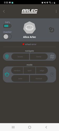

this last image is where you should find the notification of type of error.

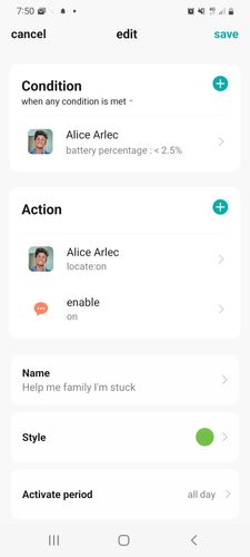

One thing that I have discovered is there is no notification if the unit goes into error and this has been confirmed by Arlec as well, so I looked to see how I could pull a notification from if say the fan stopped or the wheels stopped for a set time. But unfortunately the only thing that works is that if the unit is on and the battery is less than a certain percentage then trigger the locate alarm and send a notification as per the following.
