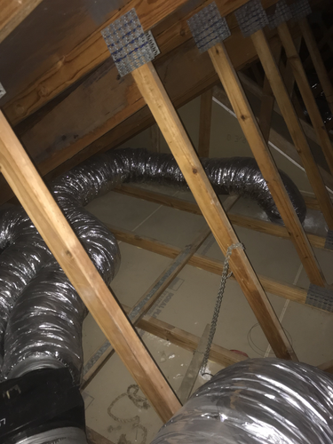

We have access to the roof space directly above the chandelier, so I decided to see if I could built a chandelier lift. This is what I found directly above the chandelier: a simple chain nailed to the stuts with another chain safety loop over a small piece of cross wood.
Original chandelier mountOriginal chandelier mount
I didn't know whether the chandelier was maybe also mounted into the ceiling structure, so my first task was to figure out whether I would even be able to lower the chandelier just working from the roof space. Luckily it was simply hanging by that chain, which meant my project could go ahead.

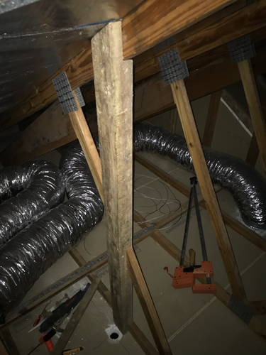

I bought a simple 100 x 75 mm fence post from Bunnings and prepared it for vertical installation in the roof structure with the help of a Ryobi circular saw and some other basic tools:
Easy with the circular sawEasy with the circular sawWearing goggles and mask against the dustWearing goggles and mask against the dustReady to go up into the roof spaceReady to go up into the roof space

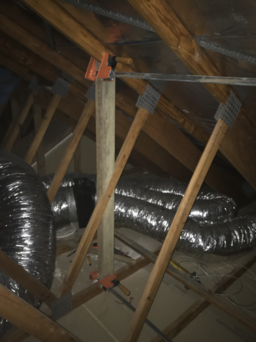

With this vertical beam installed like this, it's resting on the roof support structure, and I used 6 long M7 screws to keep it securely in place:
Clamped in placeClamped in placeAll screwed in nice and tightAll screwed in nice and tight
