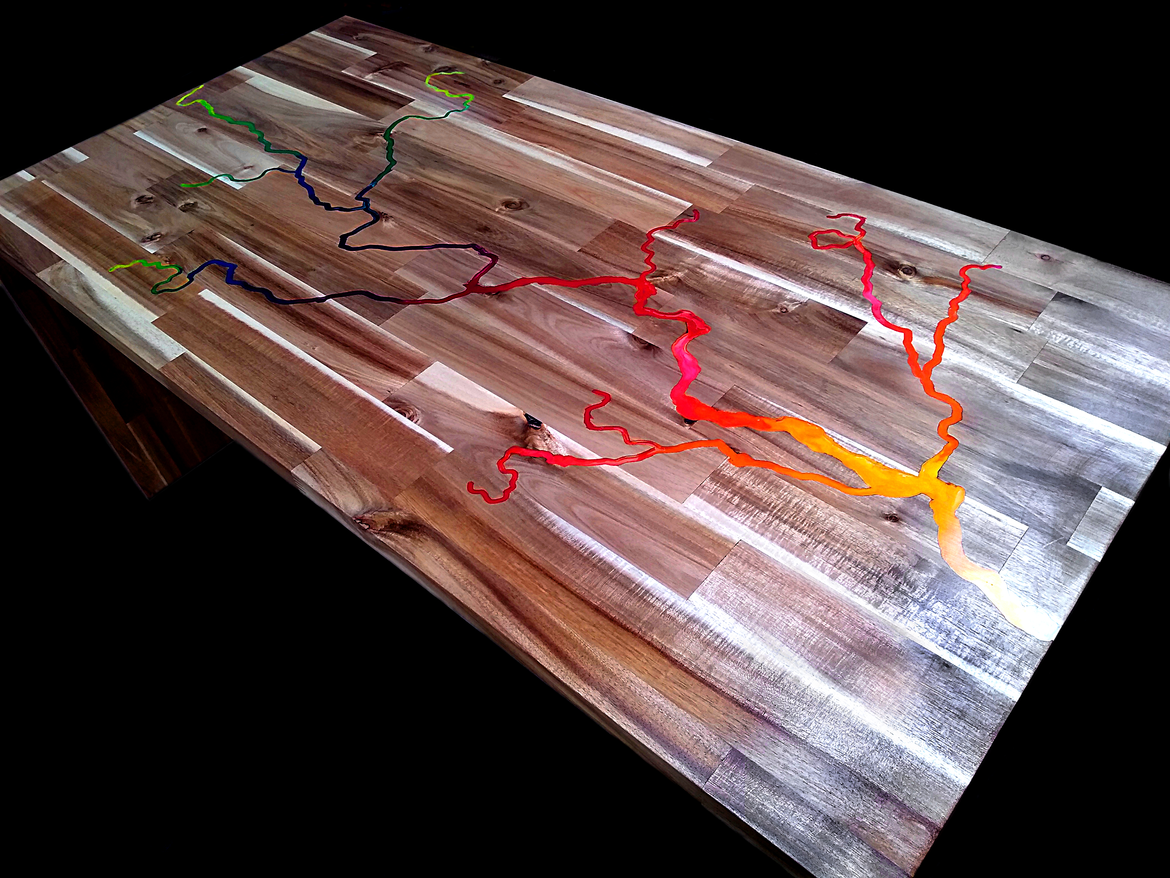

full.pngBegin by routing your design, a suitable depth of around 8mm, or half the thickness of your board depth.Begin by routing your design, a suitable depth of around 8mm, or half the thickness of your board depth.Break up crayons and lay them in the groove, melt with a heat gun.Break up crayons and lay them in the groove, melt with a heat gun.IMG_20190221_145614.jpgScrap back excess so, crayon layer is flush with surface.Scrap back excess so, crayon layer is flush with surface.Sand with orbital sander, to remove residual crayon.Sand with orbital sander, to remove residual crayon.Apply Cabots Cabothane to finish.Apply Cabots Cabothane to finish.Sand and re-coat till desired finish.Sand and re-coat till desired finish.
If your are interested in the products I used to create this coffee table, they were-
-Interbuild 2200 x 600 x 26mm Acacia Solid Oiled Hardwood Project Panel
Acacia Bench top $99
-Cabot's 250ml Cabothane Clear Interior Water Based Varnish
Cabothan water Based $18.30
-Ryobi One+ 18V Random Orbital Sander - Skin Only
Ryobi Random Orbital $99.90
-Ryobi One+ 18V Trim Router - Skin Only
Ryobi Trim Router $99.00
-Ryobi 2000w Corded Heat Gun
Ryobi Corded Heat Gun $79.90
