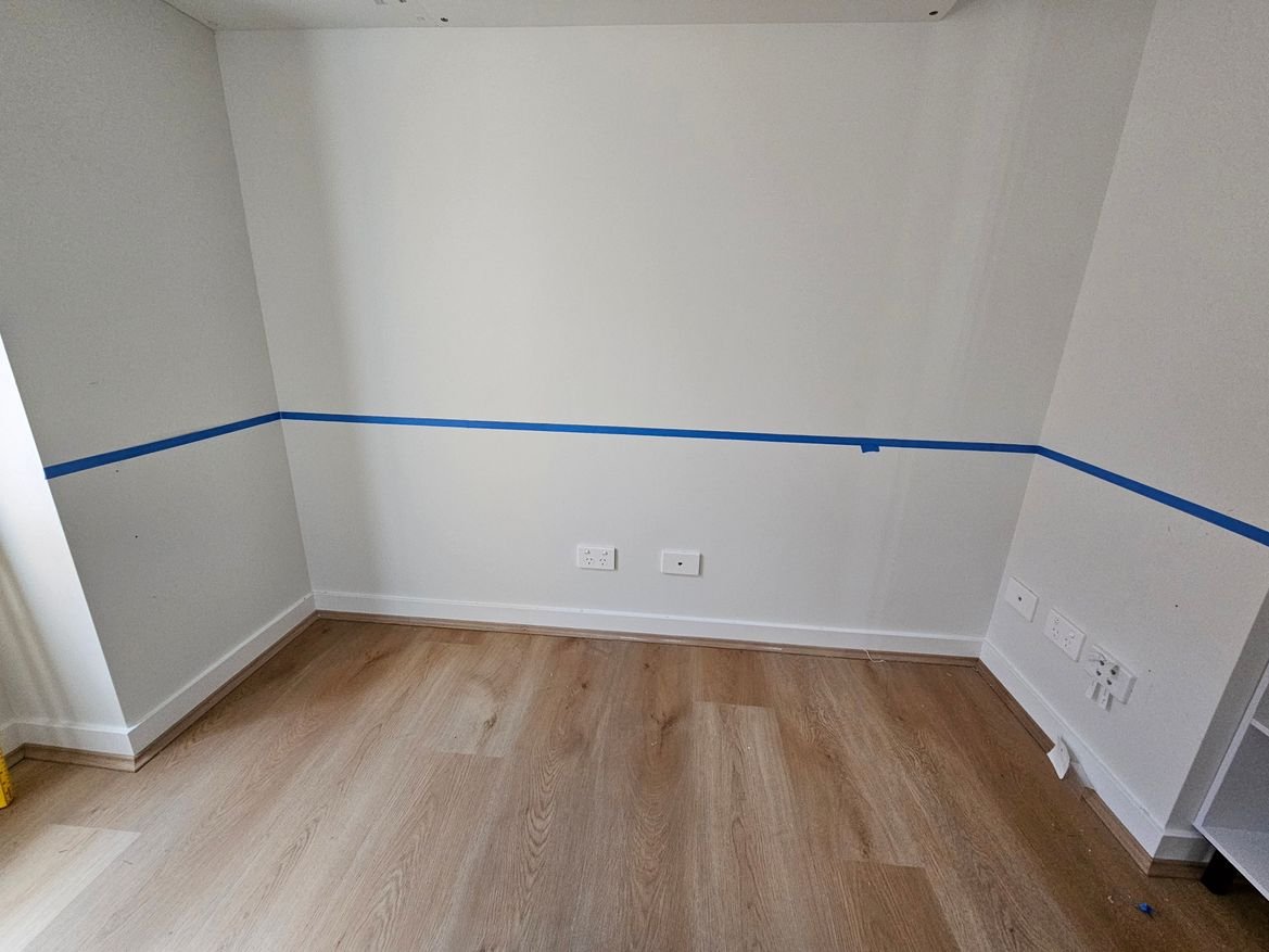

I started with creating a line marking for the desk using ScotchBlue masking tape and Stanley spirit level.

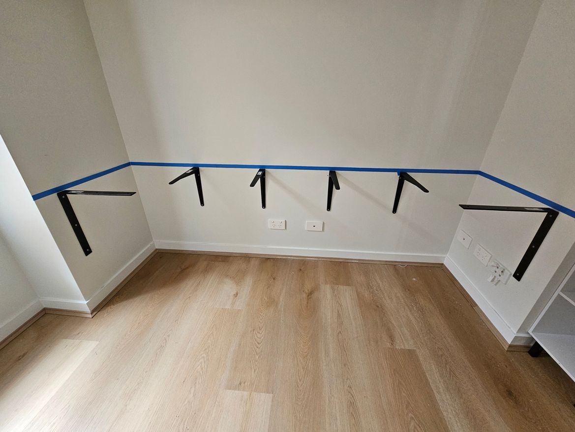

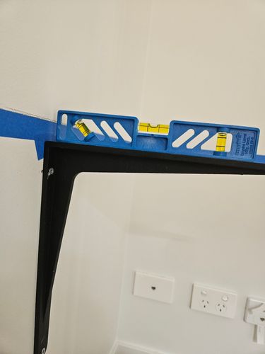

And then I installed the angle brackets on the studs. I wanted to avoid sagging so in total I used 6 angle brackets to distribute the weight evenly. I checked the levelness after installing each bracket to ensure they're level.
Check levelness for each bracketCheck levelness for each bracket Check levelness for the brackets on the wide sideCheck levelness for the brackets on the wide side
Angle brackets are installed, ready to mount the desktop on to them.
Angle brackets installed and readyAngle brackets installed and ready

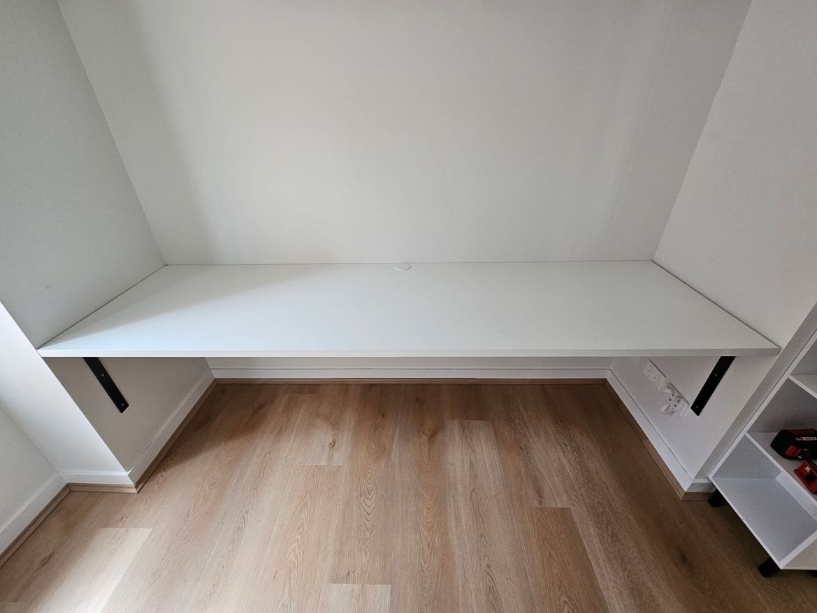

Before I mounted the table top, I cut the top to size (2,250mm). I was initially planning to use Practa 2400 x 600 x 25mm White Laminate Worktop, however the nook depth was 635mm and I wanted to have a flush desk, so I ended up buying another table top which coincindetally have the perfect depth.
I used a hole saw to drill a grommet hole for the cables. I bought the taskmaster white cable duct which fits nicely. After the table top was ready, I mounted it and screwed it to the brackets. Here's the result:
Here's how my study room looked like after the makeover. I'm pretty happy with the result, considering the builder quoted me around $1,000 to fit out the floating desk plus a set of drawers.
In total, I spent $ 236.2 for materials.
