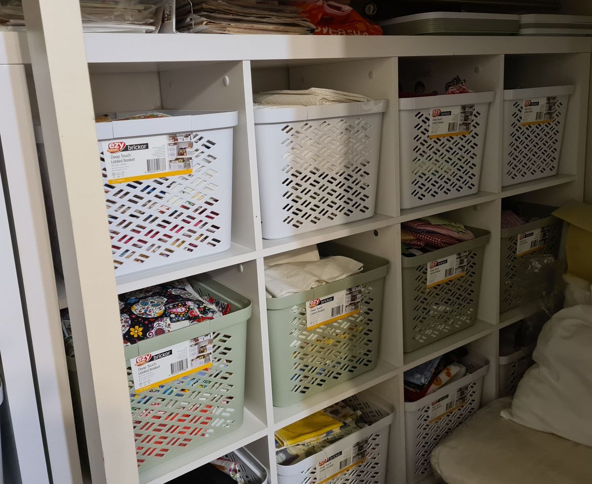

I replaced all the plastic tubs with one 14 cube storage unit and one 8 cube storage unit + ezy brickor plastic baskets (all from Bunnings, including all the materials to make the desk)

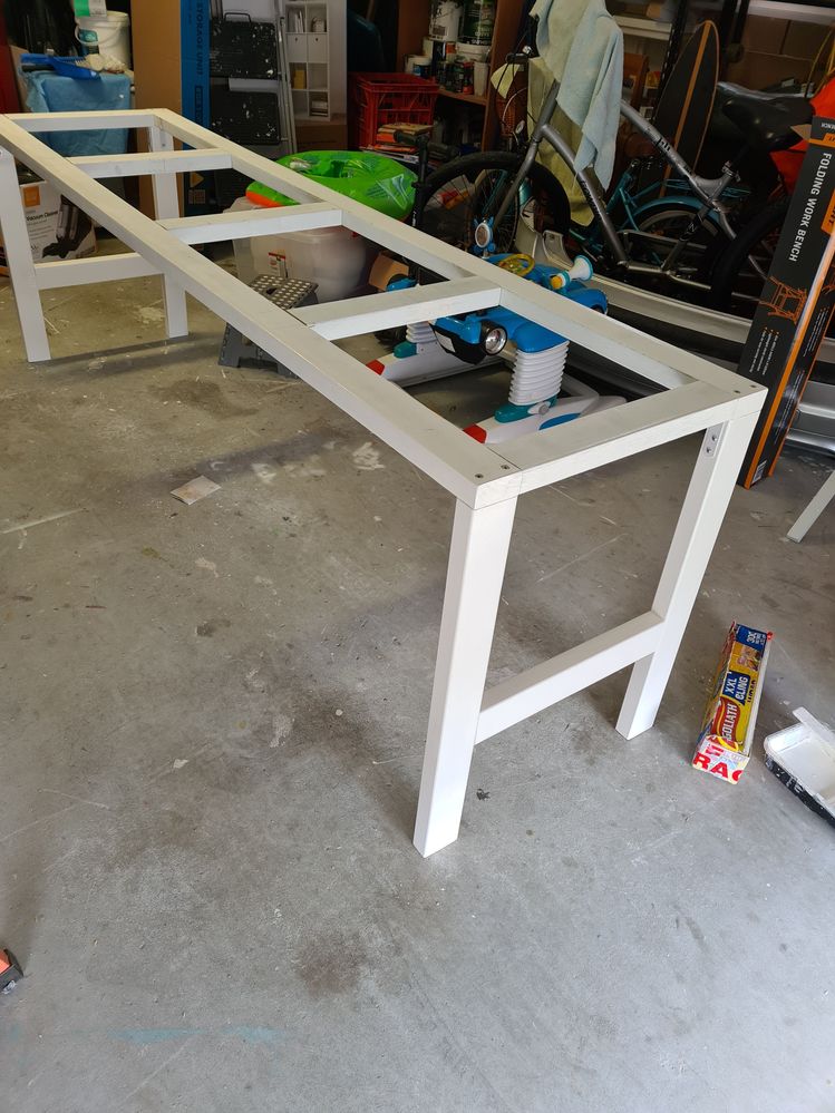

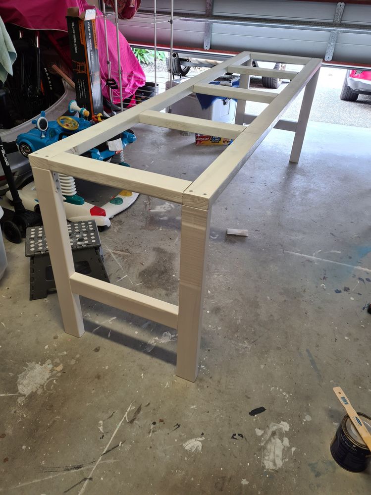

I put 1 coat of Tradex Ultra prep then 2 coats of Tradex oil based enamel on the frame and 4 coats of Monocel oiled based satin clear wood varnish on the benchtop (sanding between each coat with 240grit sandpaper)
I just love using both these paints. They give such a good durable finish.
As I made my desk 2.2mts long (to fit all my machine) I had to put 4 bracing pieces across the top of the frame (at Nham's suggestion) and one long one in the middle to the floor so it wouldn't sag when the benchtop went on

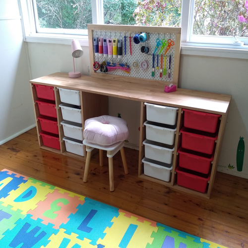

Let me tag one of our resident Bunnings D.I.Y. experts in @EricL to see if he could share some thoughts with you about how to create a simple, low-budget sewing table.
You might be interested in the guide How to create a kids craft table with storage - it could be adapted to your needs.
