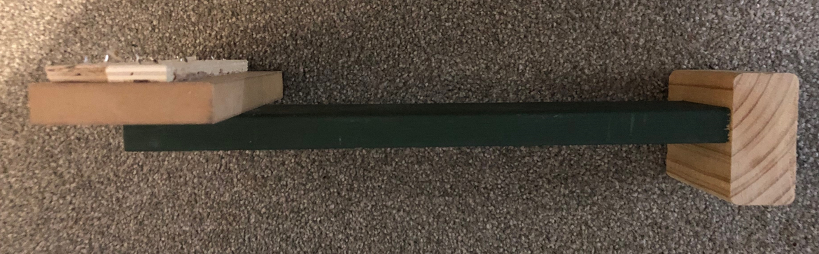

I had about 3 lineal metres of carpet to 'retack' onto the tacking strip (the strip that is nailed/glued to the slab/floorboards/whatever and has spikes pointing towards the wall...that stuff!). Bunnings have a great product to use should you wish to DIY that type of carpet installation...
https://www.bunnings.com.au/capitol-d-i-y-carpet-installation-kit_p6820043
However I didn't really want to outlay that sort of money for such a small job...so I dodgy'ed something together that worked well enough! It is pretty self explanatory from the photos I think...though once everyone has managed to stop laughing hysterically at how lame it is
I can give details if you wish!

Side view
Top view
Carpet grabbing part...may be tough to see but the 'tacks' on the wood strip are pointing forward

I totally agree though...grab a couple of spare rags <or whatever> and put some cushioning on the end of it! I found that as the spikes weren't as long as the proper tool they didn't grip anywhere near as well; so to compensate I just left my knee in the same postion whilst pushing down on the front part with the 'carpet grabbing spikes'. From there I just sort of shifted my knee forward and made sure that the tacks held to the top of the carpet - and that when ready - the tacks on the concrete slab engaged as well.
Definitely took a couple of goes and a lot longer than the proper tool; plus I think I will redo bits of it once the Walk In Robe is completed (not sure if I mentiond that as the area that I needed to do it to?). A the end of the day though; I had 3 lineal metres of carpet tack strip to fix. I just wasn't going to get a tradie in to do it and I wasn't going to spend $70 for the decent Bunnigs unit....I think most DIY'ers have encountered smaller things like this where you are stuck for a solution!
