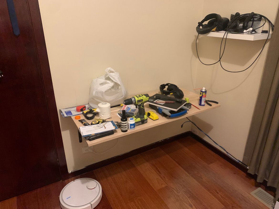

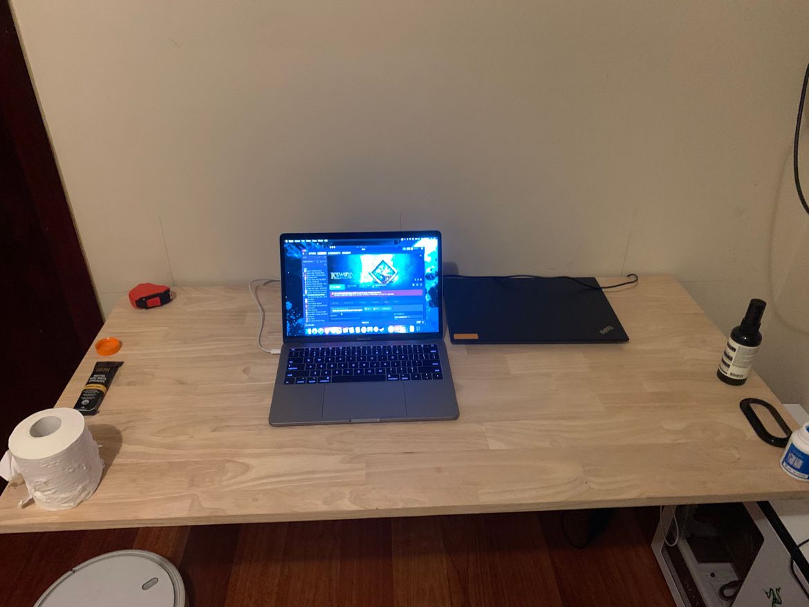

Thanks for your feedback! I ended up going with Carinya;
https://www.bunnings.com.au/carinya-400-x-350-x-25-x-3-5mm-black-stayed-straight-bracket_p3970225
With a much lighter and smaller tabletop than I originally planned as a kind of test run.
So far I'm pretty confident it's sturdy but gonna leave a couple of old text books on it for a few days before I paint it and setup the PC hehe.
Unfortunately I can't seem to post a photo right now, i'll try again later!
Let me know if you need a hand with uploading a photo @Bendt. I'd be happy to assist.
Looking forward to seeing your shelf.
Looks like it works now!
Great job @Bendt. Well done.
Looking forward to seeing your next project! Let us know if you need a hand with anything.
