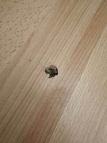

I’m living in a rental and have dropped a large glass bowl on the laminate floors boards, which as resulted in a large chip. Is there a chance I can fix this myself? Or would the section need to be removed and replaced? Photo attached!

I have seen repair videos where a small area is cut out with a stanely knife and replaced with a similar sized one. Have you had a look around flooring places/bunnings to see if there is current stock of what you have? If there isnt then maybe underneath something (behind the fridge type deal) that you could steal a small piece from?
Or better yet!
Just had a squiz on youtube for ways to fix laminate flooring. Saw this! Fix laminate flooring from laptop drop Seriously worth atry! Id try a practicepiece first of course but this way dosnt require any cutting or gluing!
Would love to see the after pic if you try it ![]()

It's fantastic that you've received excellent advice from @Dave-1. Just to add to the suggestions made, I recommend having a look at Timbermate Timber Touch Up Kit - Mixed Colours. This kit should be perfect to fill up the damage on your floor.
There is also the temporary option of using Boyle 1.5m x 45cm Wood Parquet Self Adhesive Film. Simply cut a small section similar to your floor and paste it over the damage. Please note that the patch is only a temporary fix and will not last a long time.

I think that's a very important note to make @EricL . Basically you're putting coloured candle wax in a hole on a floor, which is subjected to friction, dirt, grime, shoes, boots, chair-table legs, mops, water spills, etc. Admittedly we did not buy expensive floating floor, but I tried the wax sticks and with a little bit of artistic skill (as per @Dave-1's video) it came up beautifully. You couldn't tell where the misadventure with a falling knife occurred. At least, I thought, it might prevent water/moisture intake.
That was 2016.
But now...
I'm thinking @kate7 - try using the wax sticks now, for experience - but when you decide to move out of the rental, do it again.
