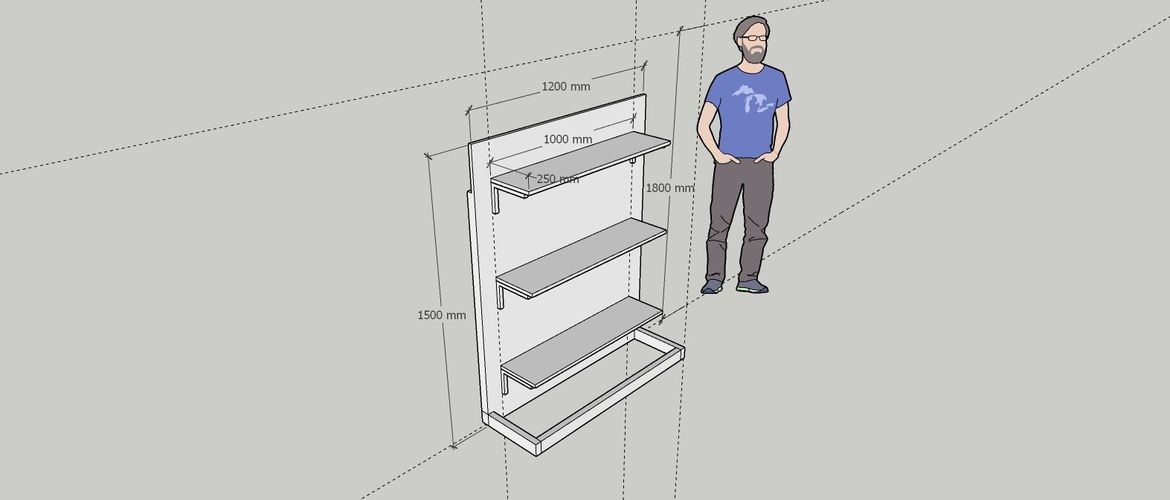

An interesting challenge! The only solution I can imagine is to create your own, removable, free-standing wall to attach the shelves to. That would mean creating a 3 sided unit, perhaps using MDF as the wall and a frame each side to keep it square & upright. The side frames could point backward or forward of the artificial wall, as suits, but forwards would be more stable. Perhaps you can put some artwork on the side frames too? Then decorate it to suit & attach the floating shelf to your own, non-heritage wall. This will make attaching the shelf easy, since you can get behind the "wall" before pushing into place.

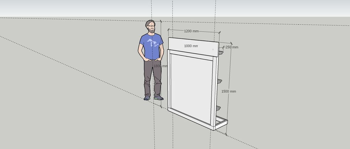

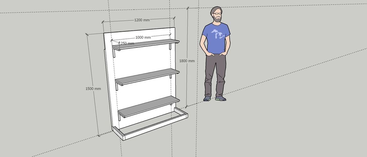

I have a general idea of what you wish to achieve. Expanding upon @TedBear 's idea you can build an artificial wall or a display wall where you can attach prebuilt floating shelves or make your own custom size ones. Below is a possible drawing of Ted's idea. I've added some extra support so that the wall will be self standing and should support art work in both vase form or framed works. You may position the shelves in accordance with your displays.
1 x MDF sheet 2400 x 1200 x 16  $36.00ea ( wall and the off cuts as shelves )
3 x Non structural pine 2400 x 70 x 35 $5.00ea x 3 = $15.00
1 x small packet Zenith chipboard screws 8G x 40 $3.60ea
1 x small packet Zenith chipboard screws 8G x 75 $6.00ea (est.)
6 x Carinya white strong hold bracket 150 x 200 $2,78ea x 6 = $16.68
1 x can of 4L Spring white paint $16.50
1 x ordinary paint brush $4
Total Budget to make 1 wall with shelves : $97.98
Tools needed :
Timber Saw ( manual or electric )
Electric hand drill
Philips screw bit for electric hand drill
Tape measure
Pencil
Time & Effort
Now each of those floating shelves is $32.55 if you purchased 3 you would still need somewhere to hang it on. I hope this suggestion helps, there are other ways to display your artwork but what I've drawn is based on an assumption that it has to be on a shelf. Should you require other ideas for a possible display please post and we will try to make other suggestions. Good luck and stay safe.
