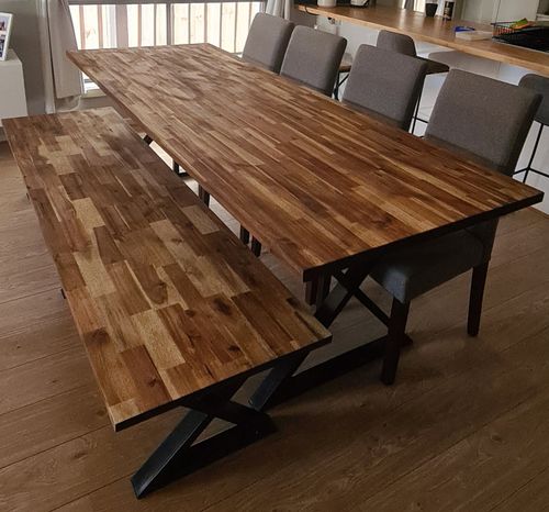

I did the table and the bench, but didn't do the frame below as it didn't seem to buckle and the bench I added a support in the middle.
The issue that I've in both the table and the bench is that it wobbles, as if it needs bracing. Is  there a solution to this problem?

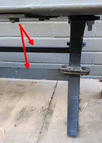

Not the same situation but a similar problem - a large bench seat.
Despite vigorous bolt and nut tension - it continued to rock slightly - side to side.
The 'cure' was two steel plates welded at the ends.

When you say wobble, are you referring to the entire table itself or the legs being uneven and sort of tilts off balance because of the bottom not being even. It is a very heavy benchtop that you are using and could be the cause of the movement. The middle support leg might need to be installed out of line to provide a counterbalance to the linear installation of the table legs.

Side to side wobble, the reply above is more inline of my thoughts to add a beam to connect the legs at the X intersection, but don't have a thought of how to do it cleanly : (
