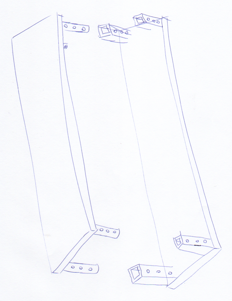

So here's how I would do it. Make two bases. The top base would be where the monitors would sit. On the four corners mount these:
40mm Pinetrim Dowel - Bunnings New Zealand
Make sure to have them about 30 or 40mm in from the edges.
For the bottom base you'd build boxes that the dowel would slot into. Then drill holes that smaller dowels would fit into to lock everything in place.
Here's a quick drawing that I made to show what I mean.Dirty drawing of monitor stand
Hi @woodenwookie
Thank you so much for sharing that idea. That is an excellent way to adjust the monitor stand without having to resort to complex mechanical methods. Plus, it's easy to assemble and you don't need special parts or tools to put it together. Let me tag @evo75 to make sure they see your fantastic recommendation.

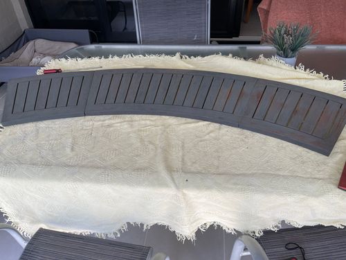

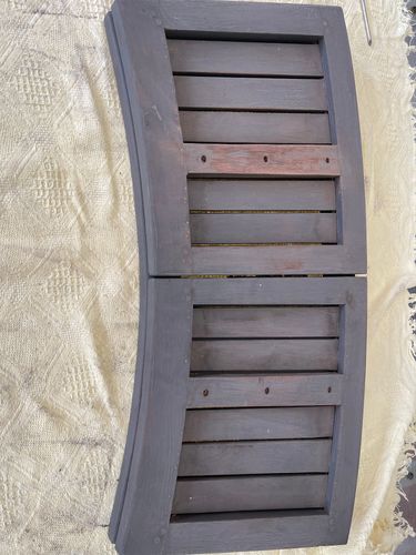

Thank you. I am going to try and restore this (top of bar). It’s around 140cm.
this below pic if lulls the top folded however providing if fits on my desk will keep it full length. Maybe a short dowel leg with adjustable level feet?
It looks like you could turn that bar top into an amazing monitor stand @evo75.
Dowels with adjustable feet could work. We also have these adjustable Adoored 50 x 100mm Round Cabinet Legs.
