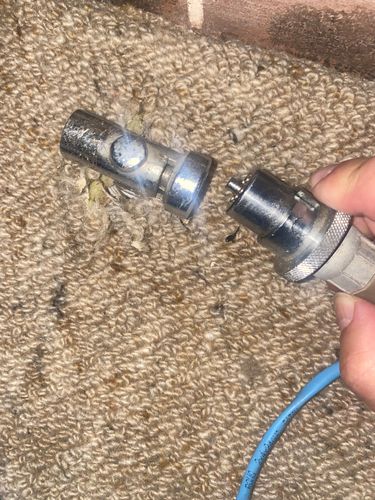

we are renting a house with a gas, we have located the gas bayonet for heating in the lounge room. But our heater has a 1/2 inch bayonet and it looks like the floor bayonet is 1/4 inch. Is there anything I can do ? New hose or a connector ?

That's an older, smaller sized bayonet fitting. I suggest that it would be best to approach the landlord to see if they would be willing to change the fittings to the newer, larger size. Not only would this help solve your issue, but it would make the fitting compatible with future tenants. Please be advised that changing this fitting requires professional installation and is not something you can do yourself.
I'd be concerned that changing your hose to a smaller size might restrict gas flow to your heater, so I'd be hesitant to suggest you go and do that.

We had a 1/2 inch bayonet installed by a plumber into a wall a few years back. He had to extend the gas line about five metres.
The cost was around $200 which at the time I thought was good value.
I'm thinking to replace your fitting should cost less?
