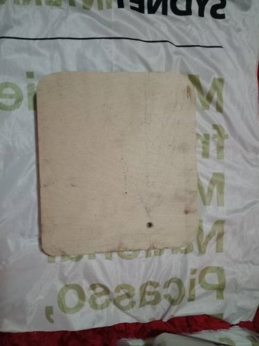

Here is a photo that shows were I should have used a circular saw for a straight cut between corners of a seat base I was upholstering a couple of days ago. ... Yes the cuts are not the best and I was being lazy and didnt want to go get the circular saw :surprised:
If you xoom in and look at the "straight" edges you can see a wave... I was using my jigsaw for the hand drawn corners on the timber and then just continued with the cutting. Its "ok" as it will be hidden by the cushion and the covering but "wiggles hand" not the wisest or easiest way to go.
