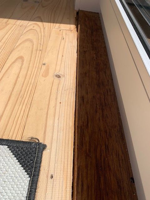

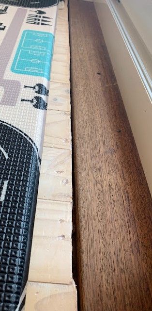

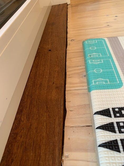

I had new sliding doors put in and a new threshold installed on all doors that the doors sit on. The gap between the thresholds and floor boards is 5mm at its thickest (apart from the big missing bit on Door 2).
Looking for some ideas to fill the gaps. I am not keen on gap filler as it needs to be very flexible (cops full sun for a lot of the day and gets cold at night) and handle traffic. Most of the gap fillers also say <3mm gaps.
I was looking at I/N: 0083890 or I/N: 0083866 and attempting to cut it length ways as it needs to be no more than 19mm wide as that is how thick the pine floorboards are. I would also need to get rid of the rounded edge on one side. I could probably expand the floorboard/threshold gap to 5mm all the way along with some chiselling.
Any other easier ideas please?
Door 2Door 2Door 1Door 1Door 1Door 1

Is there any change in height between the new threshold and the floorboards? It's difficult to tell from this angle.
The simplest solution I can think of is to use Liquid Nails to glue either QEP 25mm x 2.5m Transition Cover Trim or a Metal Mate 25 x 25 x 1.6mm 1m Aluminium Tee Section in the slot.
Alternatively, you could cut along the floorboards to open the gap up to a minimum of 10mm the whole way along and slot this Porta 50 x 30mm 2.4m Tasmanian Oak 'T Rounded' Astragal into the gap and glue it with liquid nails.

There is probably a 2mm rise from the floorboards to the threshold.
The two metal options are a good idea, as long as there is some flex in them and I could use a rubber mallet to bend one of the sides down to meet the slightly lower floorboards, or flatten against the threshold.
I really wanted to avoid opening the gap up more as it would be pretty tricky. Door 1, which has the floorboards butting up against it, has its joist nails very close to the gap. It would also be an awkward cut with a multitool (unless you can suggest another tool) to evenly widen it to 5mm all the way.
Do you think I would have success getting something like the edging bead mouldings I mentions in my original post, hammering it in and then trying to knock off the excess with a hammer or chisel and then sanding down?
