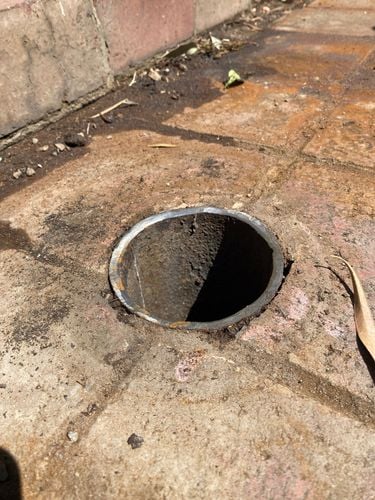

I had an old drain cover that was a hazard for kids. So have removed thinking I could easily find a plastic cover for it.
Unfortunately the standard and available size is too big.
What are my options?
The diameter is approximately 90mm. I’d like it to sit as flush to the ground as possible.

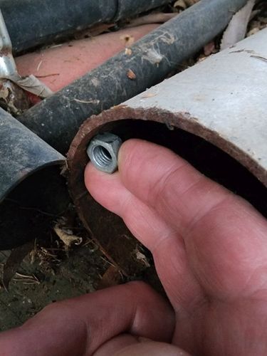

For example, in this case I would weld three nuts equidistant from each other inside the pipe - and only on their sides, not the top.
They would be on a level dependent on the steel plate purchased - maybe 5 mm thickness.
Template the internal diameter - transpose - and cut the plate and grind so that it 'drops' in place on the three nuts.
Mark the nuts position - remove the plate and drill countersunk holes to match.
Return the plate and screw down.
Everything would be then level with the pavers.

Hi @Rileythornbury
The pipe looks to be old cast iron, so it's unlikely to find a direct off the shelf solution. Measure the inside diameter of the pipe to see if any of those grates @EricL suggested will fit internally. Otherwise something curved like this grill could be Sikaflex'd to the top. It won't be level to the ground and less of a trip hazard, but nothing will be unless you can lower the top cut of the pipe.
