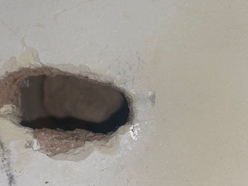

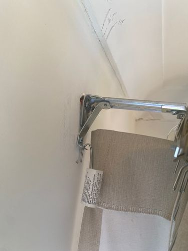

New problem today, curtain rod bracket hanging loose, strange. Upon inspection I found the 2 screws with plugs hanging in the air. The holes must’ve been drilled just where one of the 3 brick holes are, so cleaning up debris and vacuuming, I see a void as big as a tennis ball or more.
So now I need to fill or inject some filler material that needs to set really hard, so I can re-drill holes for expanding plugs and secure the rod properly.
Finally my question is: what do I use? Some cement/sand mix? If so in what proportions? Or do I use some pre-made mix I can buy from Bunnings or some specialist supplier?

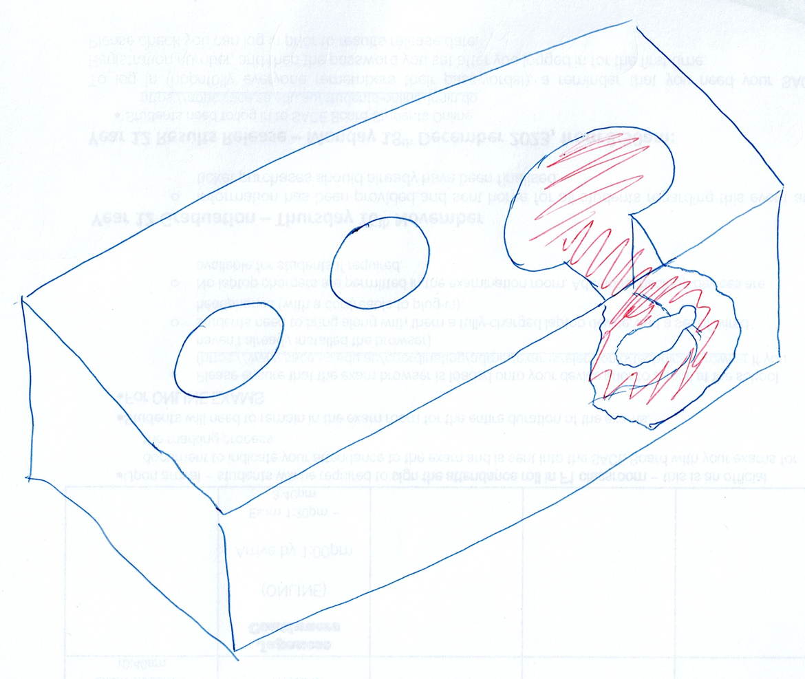

Hi Alan, thanks but that's not suitable, the hole is as big a tennis ball or so, with a thin 1 cm of limewash plaster thickness.
I've made a sketch to show what it looked like once I peered with a tiny torch inside. Now I've put the epoxy cement like filler with the 2 plastic wall plugs embedded in it, fingers crossed I managed to fill in enough of the cavity. The filler was extremely hard (viscous) wo I had to use a flat chisel to insert it like bread in the oven and then spread around before filling the hole entry hole.

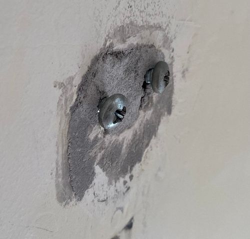

I have used the bracket with plugs and screws when I plunged the plastic plugs in the epoxy still soft, to make sure alignment and height were correct. After half an hour I removed the bracket and tested the screws hoping nothing was loose. By the amount of torque I had to use, NOTHING WILL EVER COME LOOSE! I’m confident that the issue is solved, that bracket is the most solid of all for sure. I used 1/3 of the recommended accelerant to give myself time to scoop the epoxy in the hole through the narrow opening.
i then cut off the excess and made all nice and flat, next year some paint but I’m not looking forward to undo those screws …
Re: How to fix a big void to drill again?
Hello @Rolando
Thank you very much for the update, the repair looks very strong.
