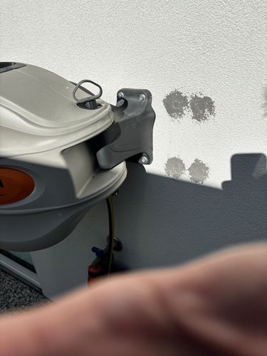

Here are the photos you requested. Not really able to put post in ground, etc. It’s either the concrete path, or the garden. Im not going to do that. It’s really the wall that is the only option. There must be a way to fix it there.
Thanks for any help you can offer.  

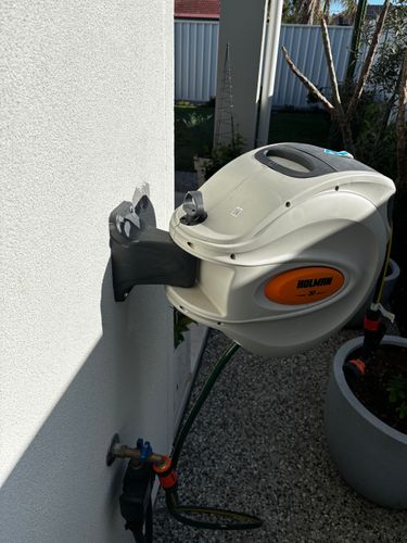

Thanks to everyone for their advice.
I’ve followed the Hebel guide and we will see if that is the best option.
Some photos of what I’ve got to.
thanks!! 
