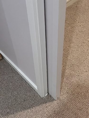

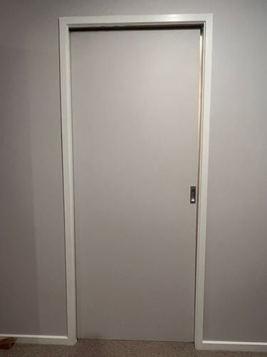

Recently we had new carpet installed in our 20 year old house. The new carpet is thicker than the old and has caused a problem with the cavity slider going into our walk in robe. During the carpet installation, the guys removed the slider to install the carpet. They put the slider back, but now the carpet and the bottom of the door are too close to use without damaging the new carpet. A builder friend came over to help with this problem, but wasn’t able to as he said you need a special type of flat spanner (?) to adjust or remove a cavity slider (He was able to help with another regular swing door that had the same problem). I’ve googled but this spanner doesn’t seem to be an easy thing to buy.
Does anyone have any ideas about what I should buy?
Per the photos, the door CAN close but is tighter to the carpet than I like, plus it’s been rehung but not square!

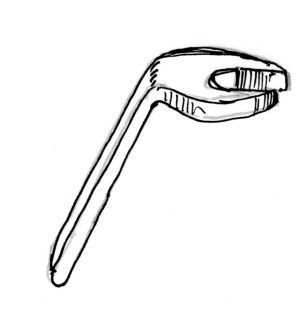

I was watching an instructional YouTube video and the guy was using an angled spanner.
Did you get @EricL 's spanner? did it work?
A rough Police sketch

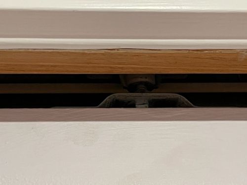

I had a look at my sliding door - clearly an older design - but I think I still see 'Cowdroy?'
An old Cowdroy?

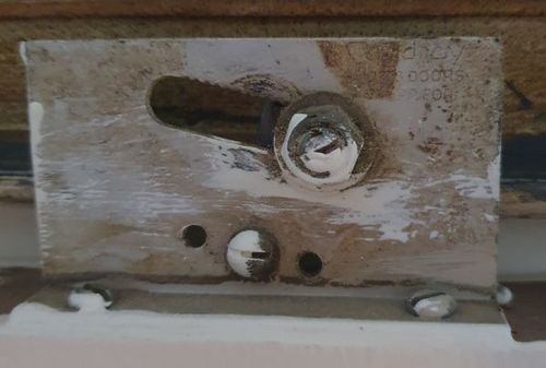

Hi Eric,
I’ve bought the Cowdroy spanner but it doesn’t work at all! It doesn’t fit around any of the nuts in the door. Any other ideas?

Hi again, they did remove the piece of wood at the head of the door. I still haven’t put it back as I’m trying to sort out the door height/angle.
Frustratingly I wasn’t home on the day they installed the carpet so didn’t talk to them or see what they were doing.

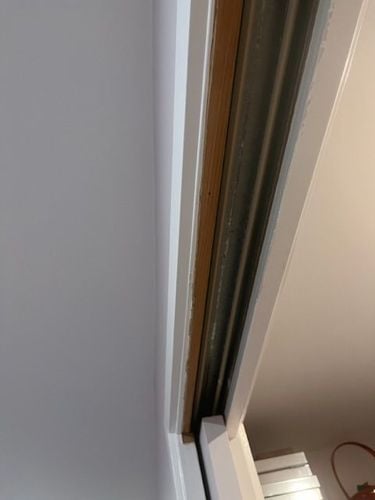

Hi @Shellcam
I'm sorry that the tool did not fit your sliding door mechanism. I've placed an image below to give you an idea of how the door is mounted to the sliding door rollers. You'll notice that on the post that links the door to the rollers, there is a nut right in the middle. This is the locking nut and must be loosened in order for you to swing the door out.
You'll also notice that the steel flange attached to the top of the door has an opening while one side is closed. If you can't see it odds are a bit of timber moulding is blocking the view. There is no need to remove both sides if the door swings out towards you. You'll get a better idea once you see the image below.
Please have a good look and if have any questions about its disassembly, please let me know.
