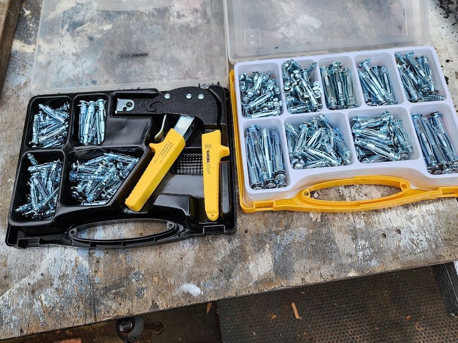

A screw from the ceiling light timber has come loose and cannot be tightened. How can this issue be resolved, and is it indicative of a more significant problem beyond simply repositioning the screw?
Re: ceiling timber lights screw
Hello @softkun123
Let me tag @Noyade to make them aware of your question. I believe @Noyade was referring to hollow wall anchor kits that include several sizes of the hollow wall anchor and the setting tool all in one package. The picture he shared is actually a good example. I'm currently not seeing a hollow wall anchor kit on the website, but it would not hurt to go for a visit to your local store to see if there are any available.
Yes, you used to be able to by them at Bunnings - Craftright?
https://www.workshop.bunnings.com.au/t5/Whole-of-House/How-to-fix-loose-ceiling-light-fitting-screw/...
These days I just stock up on Workforce from Aldi when they turn up.
But you can of course still buy the original Ramset applicator and various size anchors. Still affordable @softkun123
https://www.bunnings.com.au/ramset-hollow-wall-anchor-setting-tool_p2264163
