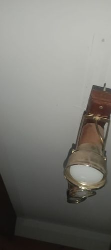

How to fix loose ceiling light fitting screw?
A screw from the ceiling light timber has come loose and cannot be tightened. How can this issue be resolved, and is it indicative of a more significant problem beyond simply repositioning the screw?

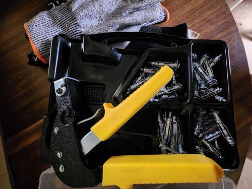

Just going with @JacobZ 's hollow wall anchor suggestion - I think it's a good one.
"Does this hollow wall anchors requires setting tool?"
Yes, but generic kits are very good and inexpensive - you'll never regret the purchase as a home owner.
Many different sizes and very strong, and yes, you can mix and match lengths - this is M4 @ 70mm.

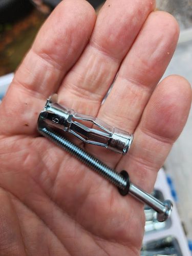

Hi
Can I use timber 10g screw length of 65cm for the anchor I purchased as seen in pic?
Though the cover says to use 6-8g of screw length 40mm
Re: ceiling timber lights screw
Hello @softkun123
Although the Wallmate piece will accommodate the 10g screw, I don't recommend doing it as it will damage the Wallmate anchor itself. There is the possibility that it will crack or split and get over driven into the plaster, thereby weaking its hold on the plaster board itself. I therefore suggest using the correct screw size or getting a Wallmate that is rated for the larger screw.

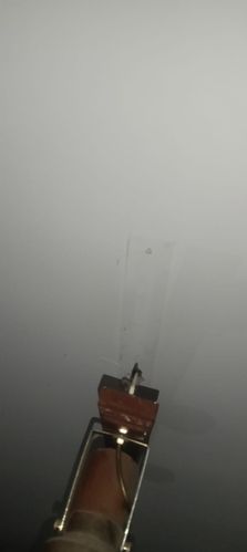

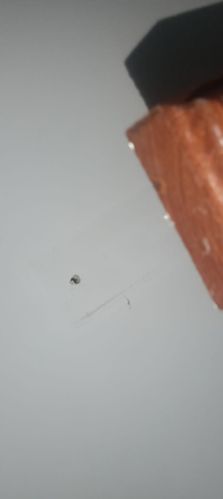

1)Can you point me wallmate anchor that would use larger screw say up ,10g and 60 mm timber screw?
2) also from pic below can you tell me whether ceiling is fibrous cement or plasterboard?
Hello @softkun123
It appears to be fibrous cement, but in either case I suggest using Ramset M5 x 9mm Plasterboard Hollow Wall Anchor in combination with a Ramset Hollow Wall Anchor Setting Tool. It is a worthwhile investment and can be used for future projects especially if you are hanging pictures.
