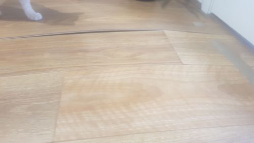

 We have had water damage near our front door and the first few boards of laminate flooring have bowed is there a fix or better to replace it?

I'm an amateur floating floor person - but to me, they look like they need to replaced, however there are more knowledgeable people than me on this forum. I'm really interested how this turns out for you - as I may be in a similar boat soon. I'd love to learn how to remove a few boards without having to lift the whole lot.

I'd agree with @Noyade's assessment that it's most likely going to be a replacement job. Will they flex back to the original position if you push down on them? If so, you could try weighing them all down whilst drying out the room with a heater. If there is any residual moisture left in them and the heater dries that out in the correct position, they could set back and remain in that original position. I can't imagine even then they'd look 100% like original, but it's worth a shot.
What's likely happened is that the whole section of the floor, including the boards on the sides of the lifted area, has swollen from the moisture. The buckled area is just where the boards have managed to spring up and release some of that tension.
