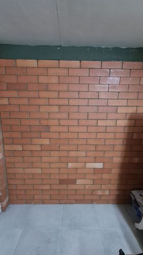

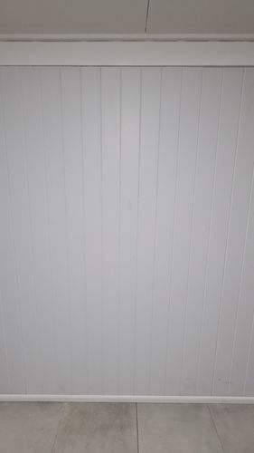

I completed a similar project almost 2 years back. Fixed VJ wall panels directly to brick walls in 2 downstairs rooms I was refreshing. Did not want to build / add fixing battons.  I fixed the VJ panels directly into the old dated brick walls. Worked seemlessly - no issues at all. Came up well.
I used Selleys liquid nails construction adhesive in combination with temporary screws which I added to keep even pressure on the wall while the construction adhesive cured. I removed the screws after a couple of days and filled the holes before painting.
For the construction adhesive I actually used a combination of 2 different adhesives from Selleys which had different texture.
Primarily I used  Selleys liquid nails Extra Strong
I experimented a little bit before hand and also did also use a bit of Selleys Liquid nails Landscape
It had a different consistency. A bit thicker more flexible and I found using the combination of both adhesives just helped with getting it to grab/set in the initial phase and also with accommodating some unevenness in the brickwork. I applied the construction adhesive pretty liberally.
I then screwed temporary screws into the panels to keep even pressure as the construction adhesive set. Removed these puttied and painted after a few days. Came up well no issues with the bondage. Nearly 2 years later haven't had an issue. Looks 100% on the old dated brick..
Some details and pics from my project here plus some pics below. Feel free to ask any questions.
