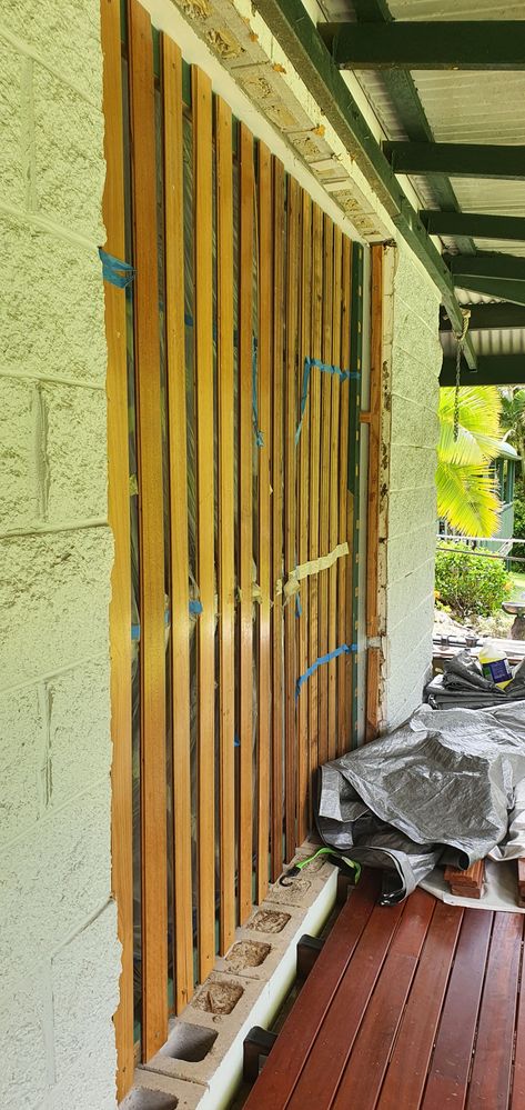

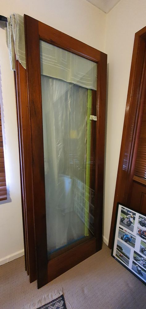

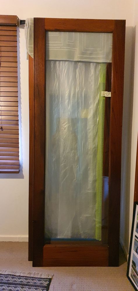

Just need a bit of advice on a reno we have found a bit challenging. We had two large bay windows that we removed with a view to replacing with 2 sets of old but fully renovated french doors. These doors will lead from inside the house to the undercover deck, so we want to install screens as well. Both spaces are basically, but not quite, the same in size. The house is besser block construction, no gyprock or lining on inner walls at all. After hours and hours of sanding, oiling then varnishing (intergrain) there is no way I am painting the french doors, so it's unlikely that I can get the frame to match, no matter what material I use.
Technical stuff : there is a rebate that seems to have been built into the top and sides of each opening.
We've decided that doors will sit at one side, with a single lite/louvres in the remaining space. Way simpler than making them centred and better screen installation options. We have access to some serious woodworking machinery - so, a great help.

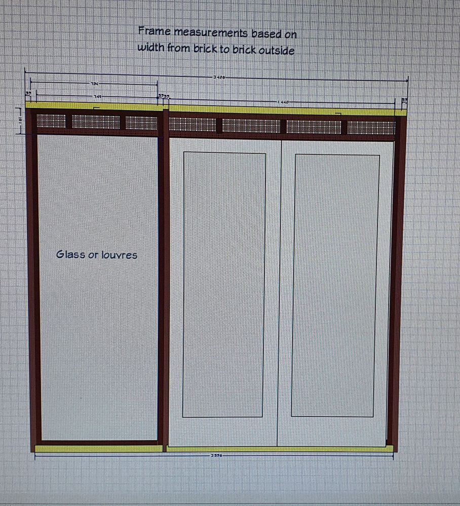

So my plan is to make the outter frames with:
The plan attached below it a bit dodgy because it is photographed from my PC screen, but gives a sense of what I am thinking will work. Thinking 'frame within a frame' for the single lite or louvres.
The bits I'm struggling with:

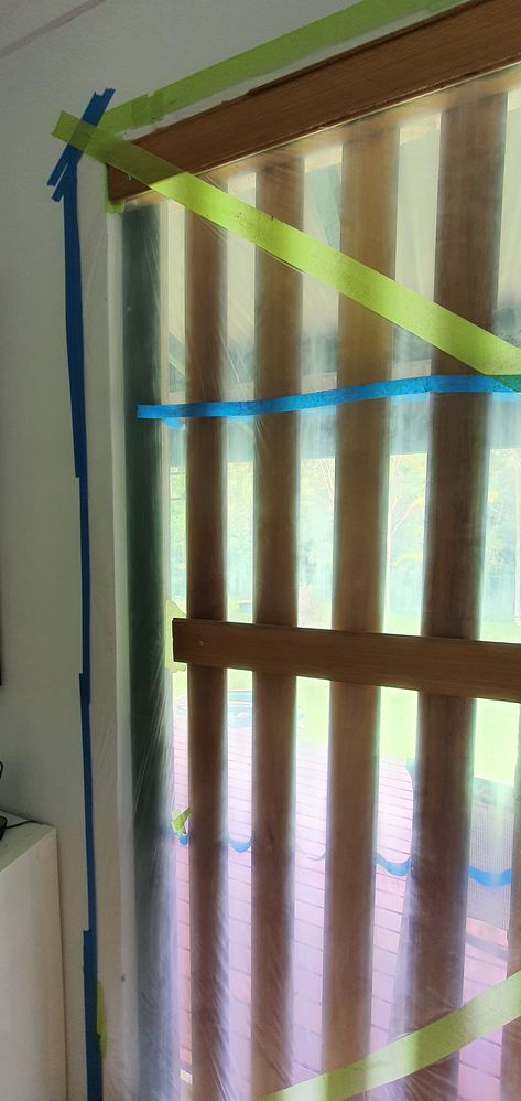

So sorry for the lengthy detail and thanks in advance for any thoughts or advice from those who have done this or know more than me! Definitely had moments thinking this one is all a bit beyond us but unfortunately can't afford to get the professionals in. My husband (a muso who doesn't share my reno passions) is getting sick of the groovey plastic temp solution, although I think it's amazing what you can do with old floor boards, plastic painting sheets and painters tape ![]()

MichellePlan done on software

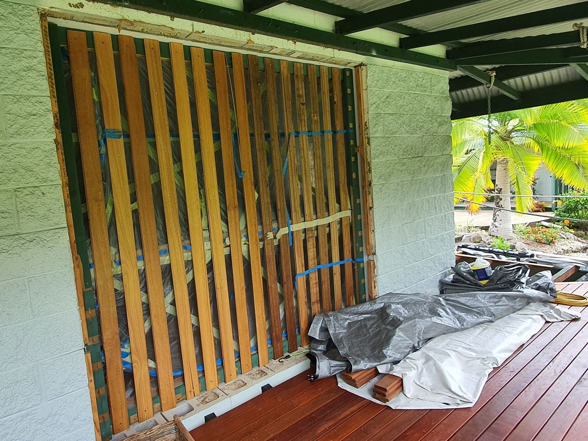

One of the spaces from outside
Outside view

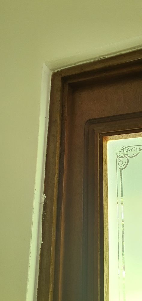

Inside wall edge - no architraves

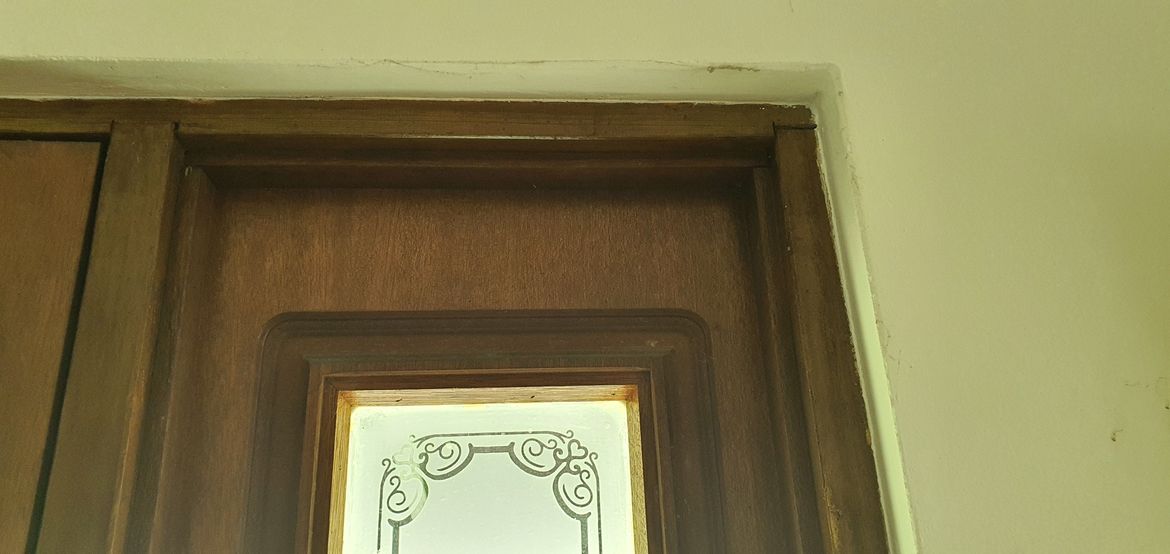

existing doors and windows all fitted flush with brick
existing frames flush with brick
French doors front on
French doors side on
Rebate detail in brick openings

Looking at that last pic, especially where there is the "rebate 8mm". There should be a lintel I think?. This is to carry the load of the bricks/wall so it dosnt compress down on the door frame itself, think of an upsidedown bananna worth of pressure on the top of the door frame.

Reading through your technical notes I think you are on the right path for sure.
Frame up the whole outside first. (factor in/find out about the lintel if its needed (Or maybe its there and I cant see it?)
Frame up the door width allowing for the jamb and the facing (pretty) timbers width and also top and bottom plates. Plus door sill height.
Frame up and face the louver window area
You have a bit of space to work with in reference to the height of the doors you are going to use. I have hung one door (internal) and yeah it was nerve wracking and I had a carpenter mate help me out
I had most of it right but just lacked the confidance. Hidden internal door for the library was my project.
To help myself visulise the make up of the door I actually used offcuts and layered them against where the door was going to get an understanding of the depth and how it would fit together.

Thanks for your post - love your hidden library door - it lines up perfectly, well done! I always have to use sketches to 'see' how it might look when making changes, but now use Home Designer software (similar to autocad but less expensive and easy to use) - it's fantastic fun and has been a great way for me to know I'm not stuffing something up.
There is no visible lintel in place and hasn't been at any stage - when we took the bay windows out, this is how it looked. I think we have to assume that the blocks above are reinforced with rebar or something as I've read this was commonly done in block houses. The peice of timber that sat in the rebar section was simply a piece of timber. They say a stud finder can detect rebar and mine went off all the way along the opening but I might look into this a bit more! May be able to install a metal lintel in that space just to be safe. Found a good Bunnings video on how to do that
The door hanging part will be nerve wracking for me but I have had some practice with internal doors but not french doors - just a bit scary making sure they are square, secure, lockable and able to be sealed well against the frame - we have so many summer-time bugs here.
Thanks for taking a look and providing your advice and guidance, very helpful! We hope to order the timber on Monday and will likely work on the 'frame within a frame' approach.

As to aust.building std's any door/window frame that has brick above it requires a steel lintel. There is a lot of weight on that frame.

Building in the 80s sure was different to today! There are no visible lintels in any part of our house above the openings. You know what they say - the more you look, the more problems you find!
