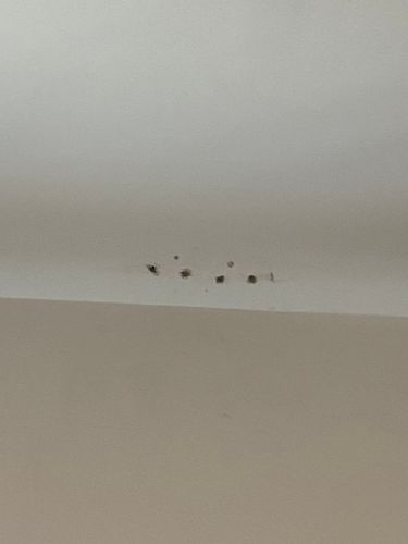

I need to install curtain tracks to my ceiling. I have tried different anchors but each attempt has been a fail. The holes become too big and the fittings aren’t secure (and by fittings this is just the ceiling clips).
What I have tried this far:
- ensure that the initial holes made aren’t too big, a bit of force has been needed to push these to ouch their original holes.
- different sizes of the gravity spring toggles, same result.
- the round anchor that I tried that you screw in, it just came straight out
it’s like nothing will hold to my plasterboard ceiling.

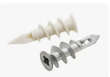

These anchors are designed to hang a lot of weight on plasterboard..
I have a heavy home theatre movie projector suspended from the ceiling with 4 of those plastic anchors.!! and the metal ones will support even more weight..
Just make sure the hole you drill is not too big..It can't be any larger in diam. than the core body of the plastic anchor..

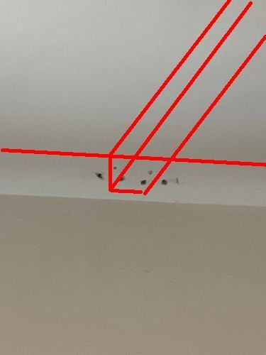

Probably my eyes - but are you drilling into the curved aspect of cornice? Is the rail heading at 90 degrees from this spot?
Any idea what the weight of the rail and curtain will be?

It's great that you've received excellent suggestions from @Prof and @Noyade. Just to add to ideas given, I recommend having a look at Tox M6 Flip Toggle Bolt, Ramset 3 / 16" x 50mm Round Head Toggle Spring - 4 Pack and Ramset Super Wallmate Toggle Anchor - 10 Pack.
The anchors I've suggested are toggle type anchors, which means that they have an opposing brace that prevents them from being pulled out. Just a word of warning that when these toggles are installed, they will be difficult to remove.
My number one tip is to test the screws of the toggle anchor on the curtain anchoring device that came with your set. You can also do the reverse and test the screw that came with your anchoring device. Please do the test before you permanently install the toggle in your ceiling gib.

It’s most probably my epic photography skills - def not a curve.
running horizontal in this, the single line you drew (Thankyou for that).
not sure of overall weight, the rails are def light but there are quite a few sheer and blockout curtains to attach, and these are weighty.
this is also my concern for longevity so inwant to make sure it’s secure before hanging them
