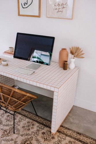

Hi Bunnings Workshop members,
I'm interested in DIYing the above desk to be the following dimensions; 700mm (D) x 1500 (W) x 730mm (H) and will be starting from scratch. Could you please advise the best timber to use for the framing and how I can approach starting? I'm wanting to use the Decor8 306x306mm Porcelain Mosaic Tiles and was hoping for a yellow grout if possible.
My only setback is that I don't have many power tools at home, including a drill for connecting the frame together. Do you have any cost-effective methods you can recommend?
Feedback is welcome!

Considering your available tools and your constant, which is your tile selection, I believe the easiest construction method would be using a 2400 x 1200 x 25mm MDF Standard Panel. The tiles you have chosen are around 50 x 50mm, so the thickness of your top and sides will need to be at least 50mm thick. If you double up the 25mm thick MDF, you are right on the mark. You can have this cut in-store, and you'll need four 680 x 700mm pieces for the sides and two 1500 x 700mm pieces for the top. You can glue these together with Selleys 420g Liquid Nails Fast Grab Strong Adhesive.
At a minimum, you'll need a cordless drill to join the pieces together with screws. Since it will be difficult to establish rigidity in the table without the use of brackets, I'd advise using some long Zenith 14G x 125mm Galvanised Type 17 Batten Bugle Head Timber Screws through the top and into your side panels. Glueing these joins will also be necessary.
It appears the creator of this table used a standard tile adhesive to attach the tiles. The other alternative would be to continue using the Liquid Nails construction adhesive.
Since it is not a common colour for the yellow grout, you'll need to custom make it. Combining Davco 1.5kg White Sanitized Superfine Grout and yellow oxide would be one way to do so. If you see a helpful team member at our Special orders desk, they'll be able to order in this oxide from one of our supplier's Australian Builders.

Couple of observations. She doesn't tile the underside? She makes it very clear how she made her table choice and the fact the table was made to fit the tiles by adding sheets of MDF.
But I can't see how her table legs are attached to the table top? If it's that awful method of the "pin and head" hardware that is locked in place with the half turn of a Phillips Head - then good luck with stability.
Your method looks good Mitchell - but even then, with 730 mm legs would you anticipate some flexing? And with regular flexing would the first layer of grout - at the horizontal leg join - break down quickly?
Would a back board - half the height of the legs - be a wise move?
100% correct, @Noyade!
The OP suggested they had limited tools, so I went with the most basic design I could think of that should work. I would presume that as the legs will definitely not be flex-free, the corner grout line will crack. However, that could likely be patched if it did happen. For those that wanted more rigidity, I'd recommend chiselling out some grooves for Carinya 150 x 150 x 20 x 4mm Zinc Plated Angle Brackets to be recessed into so that they are flush with the timber surface. Once they've been used to screw the top to the sides, they can be tiled over.
I like the idea of a backboard, though, as it would improve the situation.
