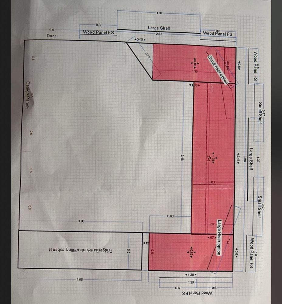

I am attempting to build a custom office/office desk from the 32mm thick custom Bunnings kitchen benchtop range. I'm going to ask to get the Bunnings team to cut the benchtops into what ever size/shapes required to ease fitment and joinery.
The desk will be supported by multiple overrated 90-degree brackets screwed to wall studs and installed with a laser level.
I want to install acoustic panelling on the walls similar to (Prempanel 2700 x 600 x 21mm Black Oak Timber Acoustic Panel)
I want to ideally use the gaps between slats to run cables to keep it cable managed and avoid drilling port holes for cables., but this presents a problem, or at least a choice. I either cut the acoustic panels into two pieces and install to the wall leaving a 32mm gap for the desk meaning the desk will be flush with the wall and will look counter-sunk into the acoustic panels (good) but leaving no room for cables to go down the back.
or,
I have the desk made to the dimensions of the wall 'with' the panels already installed, meaning the desk will be flush to the panels, but the desk will then be 21mm away from the wall, all be it still supported by the brackets. While it means I could run cables anywhere, Ibut 'm not 100% sold on how it may look, I'm also concerned about weight distribution on the brackets. Is this a terrible idea or present a structural support issue because the edge of the desk/plan.jpegcontact point is not flush with the wall putting a levering force on the bracket?
I've calculated the weight of the desk and calculated what my walls can support and I'm well within limits.
Or maybe i simply ask the team to notch some channels?
I hope this makes sense, how would everyone else go about this problem?"

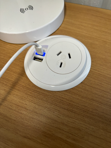

Personally I would run the cables through small access points neatly finished with these available in different colours. Or online places have aluminium ones of all shapes. Just Google "office desk cable entry points"

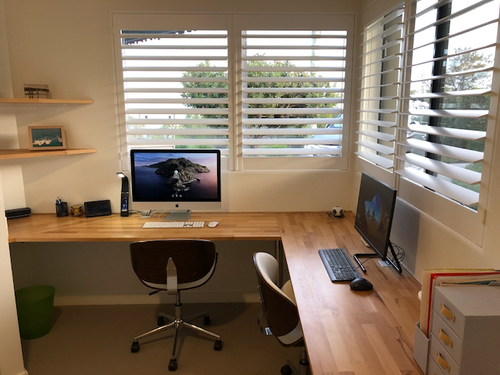

I have built many home office desks and use one of these power boards mounted under the desk and plugged in to a powerpoint close by.  I bought online a surface mounted power and USB outlet which had a DIY installation for my phone etc.
All under desk cables ate cabled tied to small clips screw under the desk or there are lots of cable management options available at Bunnings.
I've included a couple of photos that show using this technique how clean the top of the desk area is of cables and full depth with no cable trays.

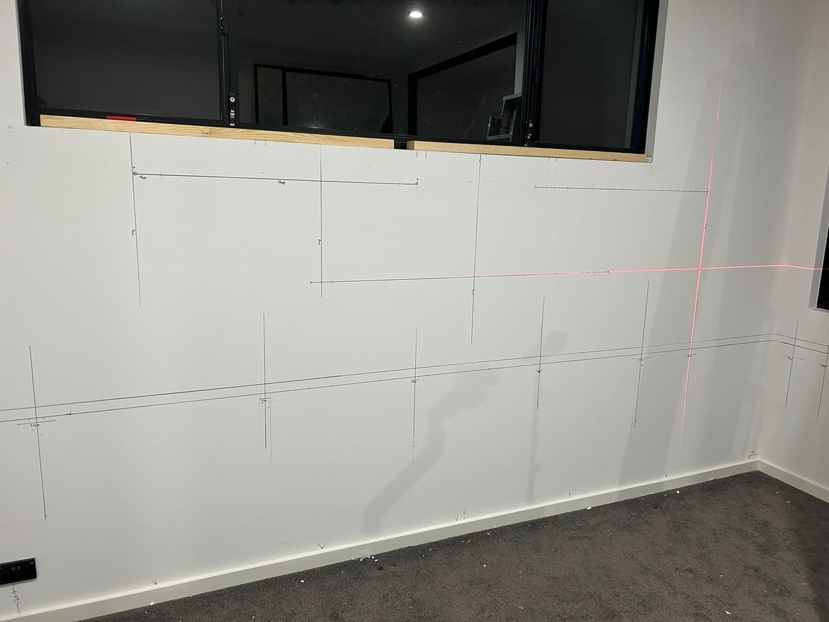

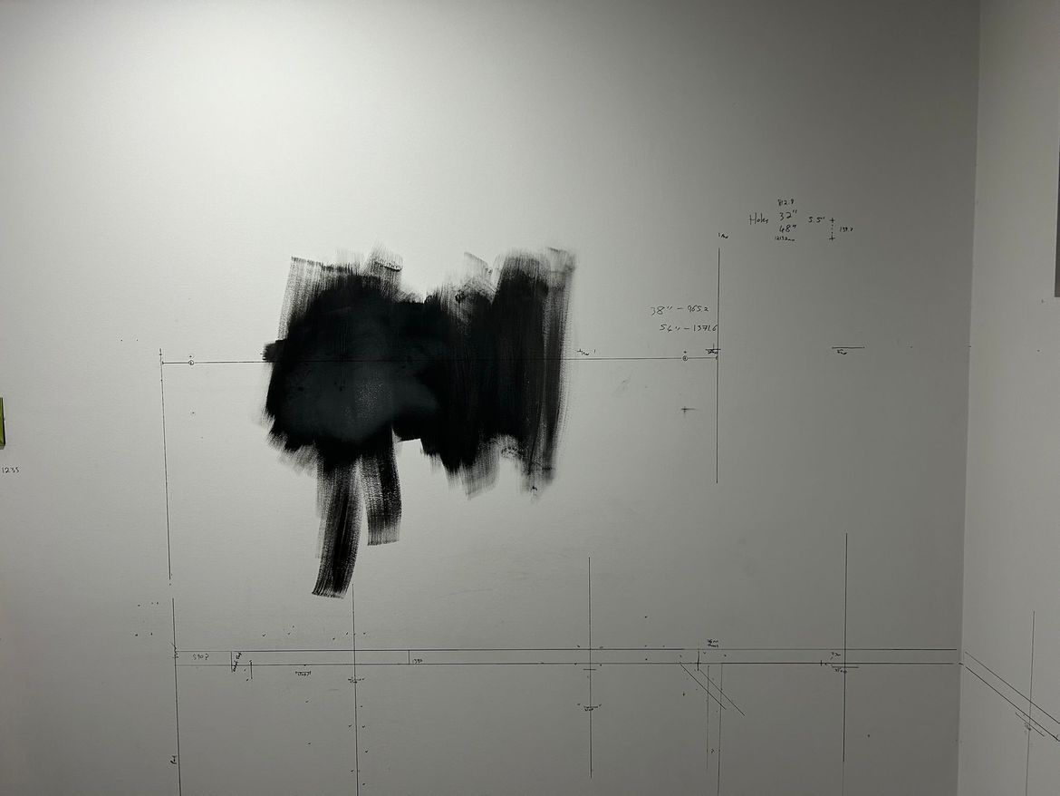

So everything is marked out. but I have more silly questions.
I didn't trust my old stud finder, it was giving me inconsistent results so I invested in your professional one that gives a better accurate and visual representation of where the studs are and how wide they are.
In using this I found:
The smaller standard studs are 35mm wide which means the carinya 290 x 240 Black cast brackets I intended to use, only just fit the width of the smaller studs. This concerns me due to the holes being quite offset from the centre of the bracket and very close to the edge of the stud if I am to use top holes. I'm concerned about splitting/failure. I don't like the idea of using alternative unreinforced brackets due to potential sag. i can't find anything with inline centre holes and reinforced so I'm considering offsetting the carinya bracket from the stud centre by about 6 mm which would mean the bottom hole and one of the top holes will be better centralised to the stud but I will only get 2 screws into the wall, not 3.
I am also going to be using batten flat head screws that fit the holes perfectly with a 5mm pilot. i haven't trailed to see if a drill will give me a decent angle to screw with the bracket in place or whether I need to buy a smaller impact tool yet. Any major red flags gents or advice/alternatives?9468ef9e-0a8b-4a62-ab88-1bc17eb2c19a.jpeg1eb47fae-82da-4f57-93b7-977b3dc72513.jpeg
