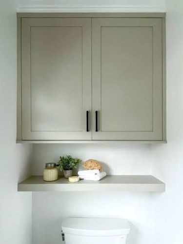

I'm sorry, but I'm not entirely sure I understand your question correctly. As mentioned above, filler panels are used on either side of a cabinet that doesn't cover a full span between walls. If you were having a customer cabinet made and your walls are square, then you'd have it made at a few millimetres less than your 850mm width. The cabinet would then fit perfectly. Some caulking filler would cover the tiny gap.
If, for some reason, you had a custom-made cabinet created that was less than 850mm, say 700mm, you would install a 75mm filler panel on each side of it, so it's snug. I've created a rendering below to illustrate.

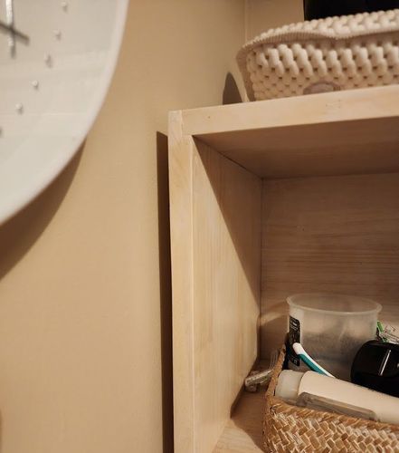

Is this the sort of look you're trying to avoid @misstcameron ?
My excuse is I made it (1.8 metres long) and could not get it onto the wall (it just holds towels) without a gap to compensate for the 'diagonal' length.
