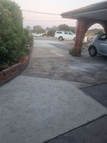

I'm grinding a
concrete driveway. I've got a dust shrowd and bought the 4L ryobi vacuum. Within 3 Min the filter clogs. Is there any solution? Would an ozito vacuum as above be any better? I haven't tried wet grinding, but that's probly my next option.
Re: How to reduce dust when cutting concrete?
Hello @Katie6025
The 4L Ryobi vacum is not strong enough to hold the grinding dust from your driveway, I suggest looking at investing in an Ozito 1250W 20L Wet And Dry Vacuum. When doing heavy dust work make sure to use the paper bag provided in the kit. Once the bag is full it can be emptied out and re-used again. The only time that the bag needs to renewed is when it has developed a leak or a hole has appeared at the bottom of the bag.
The last option will be wet grinding, but you need to make sure that all your equipment is rated for wet grinding. Improper use could result in in injury or electrical shock.
Please remember to wear personal protection such as gloves, goggles and a half face respirator mask such as the 3M Medium Paint Project Reusable Half Facepiece Respirator.
