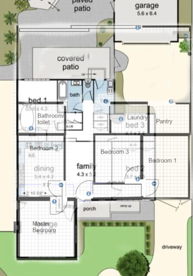

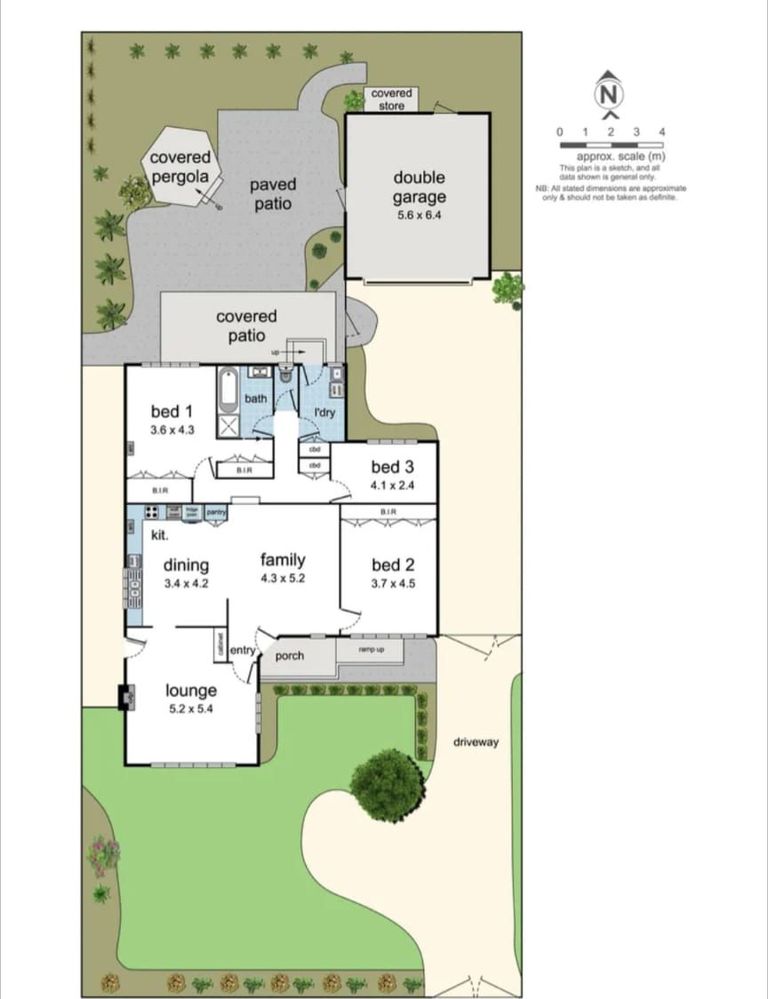

Below is the current layout of the house.
Current layout of the house

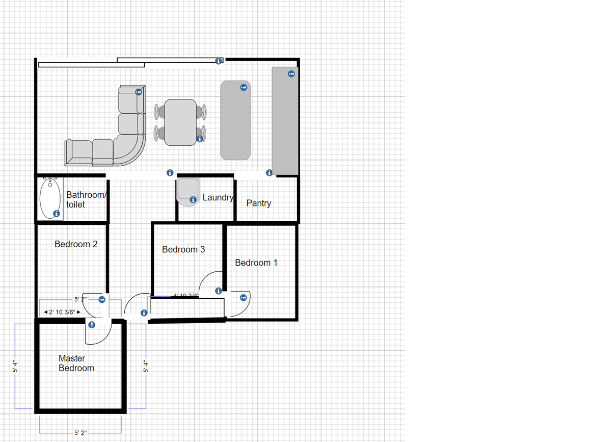

This is the rough idea/imagination of how I want it to look.
Would like to understand how I can best remodel this to achieve my requirements within my budget.
Also is this something which is achievable within the budget or am I dreaming?

Looking at your plan and using the current lounge and new master bedroom as a source of scale, it appears that the vast majority of internal walls would need to be altered. Your new plan's footprint also exceeds the current home. I understand the new plan might not be to scale. For this build to come in close to your budget, I believe you would have to utilise as many of the current walls as possible. A large portion of the budget will be used on the extension and any work that needs to be done to remove weight-bearing walls. To get an idea of if your plan is feasible, I'd recommend you enlist the services of a structural engineer to assess what walls can be removed and what walls are weight-bearing. The removal of weight-bearing walls and modification of the roof structure can be expensive. If you can incorporate the weight-bearing walls instead of removing them, you can reduce costs dramatically.
If the plans are not to scale, I suggest working on that. Sit down and look at every wall in the current home that could be kept and used in the new plan. For every wall you keep, you can add thousands of dollars back into your budget. If you can keep weight-bearing walls, then that return to budget increases dramatically and will allow you to redistribute the funds to fit-out options.

Hi Mitchell,
Thanks so much for the prompt response.
Yes, the drawings are not to scale and hence it's not very clear. Apologies for that.
But my basic plan is to retain upto the dining and bed2 of the existing structure.
The Bed 3 becomes the pantry and laundry.
Half of Bed1 becomes the bathroom.
I am planning to do an extension of 2-3 m on the north for the open plan living.
So as such not removing any load bearing walls just adding internal walls to make bedroom/bathroom.
I hope that clarifies.
Do you think this is more doable now.

Thank you for sharing more details about your remodelling plans. It's great to have a clearer picture of what you're aiming to achieve. By keeping the existing structure up to the dining and bedroom 2, as well as adding internal walls to create new bedroom and bathroom spaces without removing any load-bearing walls, you're taking a practical approach. Your idea of extending 2-3 meters to the north for an open-plan living area is a smart move and should align well with your budget.
This makes your project more achievable and helps avoid the high costs of removing load-bearing walls. Holding onto the weight-bearing and internal walls in your design allows you to manage your budget better and allocate funds for interior finishes. It would not be possible to give you a definitive answer on the costs involved; I'd suggest obtaining a few quotes from various builders on the works to help you narrow down any appropriate budget.
