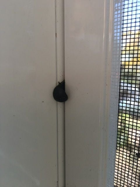

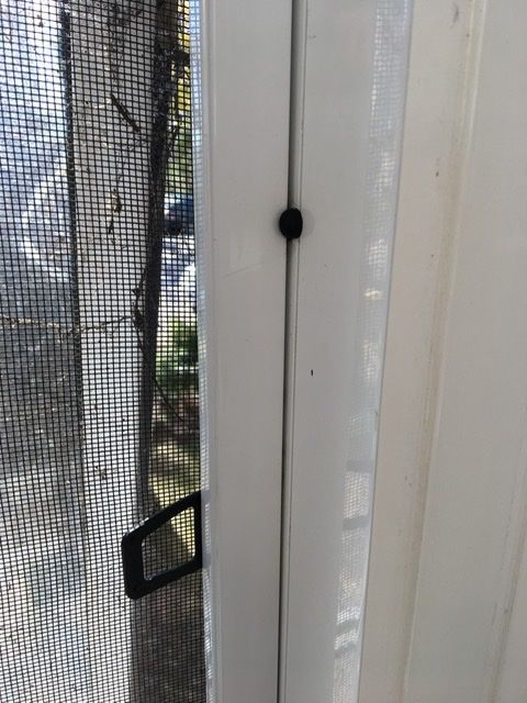

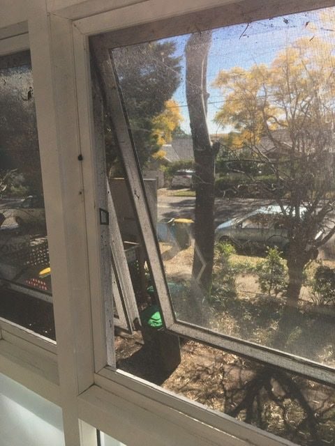

Some years ago, we had a commercial window installer supply new aluminium windows including insect screens to replace the external windows. They did a great job. Now some years later, we need to remove the insect screens for the cleaners to clean the windows on the inside and outside. However we are having an issue figuring out how to remove the insect screens.
These are awning windows with a winder. Photos attached.
is someone able to advise how to get the screens off the windows without damaging anything in the process?

Those black plastic retaining clips look oddly similar to those used in AWS retro vantage windows.
That system works with a butterfly retainer on the opposite side to those clips and is normally placed on the inside of the window for easy access. Could you have a quick check for me on the outside to see if there are any of these? If so, depress the wings, and the frame can be removed from the exterior side.
The only other potential solution I can think of is if you pull those black finger tabs towards the middle of the fly screen (not outwards towards you), they'll potentially retract a mechanism in the frame allowing the screen to be released. Most of the time, though, they are just used to grip the screen for installation.
Please let me know how you go.

As suggested, I have tried pulling the tabs of one of the bedroom screens and managed to dislodge the black clips.
However, the ones in the stairwell are quite tightly lodged into the frame; may have to be yanked out somehow without damaging the frame. Hopefully they can be put back without much problem after the cleaning is done.

Could you show us some pictures of the frame you have removed and the window frame it was removed from? Some images of the clips would help too.
It's not some type of tilt system where if you push the bottom of the fly screen frame in, the top will tilt out away from the window frame, allowing it to be removed?

I’ve had another closer look at the windows from the external. The vertical sides of the screen are up against a full length flat plate that prevents it from falling out the window.
It looks like the only way is to remove those black retainer clips and the frame should come off easily.
On hindsight, this is such a poorly designed installation.

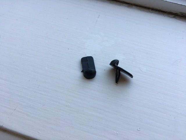

Finally, after multiple attempts jiggling loose the black retainer clips, I yanked the screen forward using both finger tabs and the retainer clips popped out on one side. Part of it broke off. Pic below.
You’re probably correct about the clips being stuck fast after a long time.
