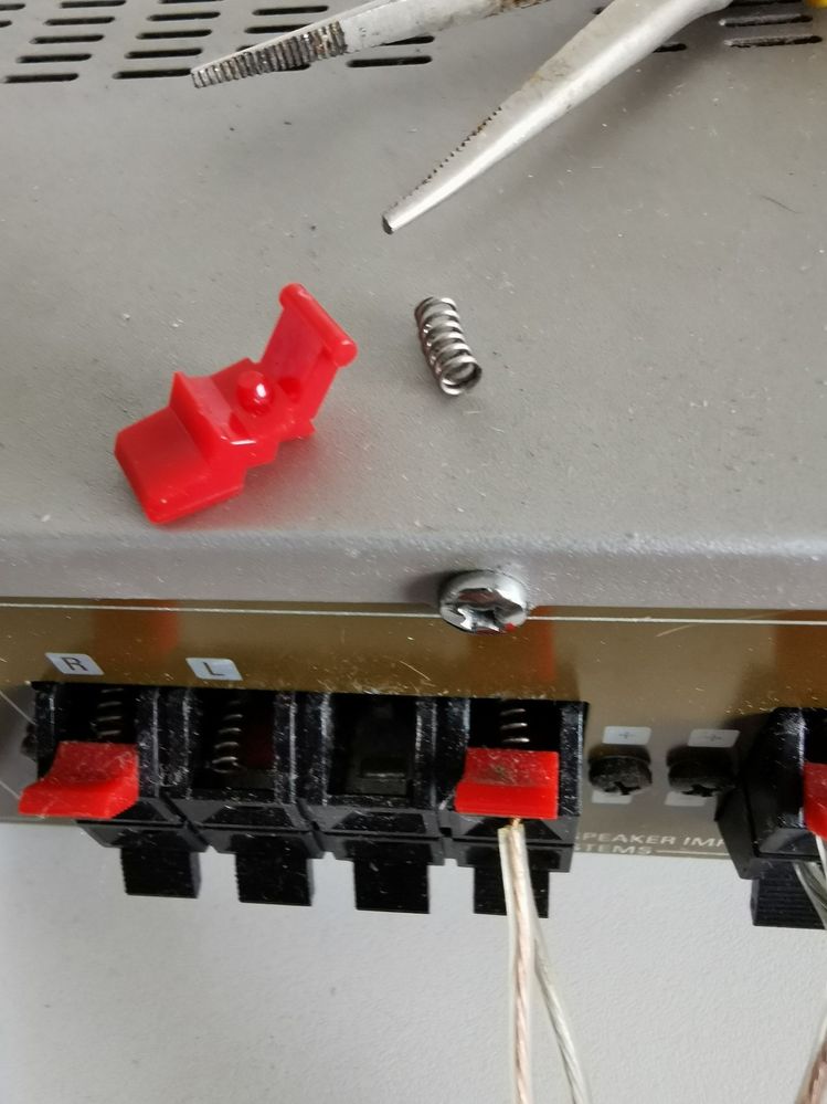

anyone have a method of replacing the speaker connector? I can't get the spring back in as there is no wiggle room and needle nose pliers aren't doing the job

I suggest trying this technique. Place the spring inside the switch body and see if you can push it back with an ordinary flat head screwdriver. The screwdriver head will need to fit inside the speaker clip assembly. Slide the switch back into place and slowly release the spring making sure that that it lands on the little nipple that's protruding from the switch.
If that does not work, my next suggestion is to put the switch inside first and then position the spring going into the back first. Using your long nose pliers in combination with the flathead screwdriver try to push the spring back into its original position.

They are a pain in the neck I must admit :/. I have tried many times to get the spring back in and have found the wiser and easier course of action is to replace the audio terminals themselves.

Id take a few photos of the terminals plus the model of the unit you have. They can look up and recommend the type to replace it with (Jaycar is an electronic store)
I had a quick look online and didnt see any 8 way terminal from Jaycar but did see one from Element 14 (Jaycars parent company)
Element 14 push terminal cable spring 8way

Hi @filthy trying to compress the spring with pliers will have been an exercise in frustration. Short of replacing the terminal strip (as an ex electronics tech, I'd probably do that) you could instead try compressing the spring with strong cotton... use a number of turns and tie it off... and then inserting it onto the plastic pip, then push it down into place. Then use a knife to cut the thread and release the spring when it's in place.
