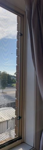

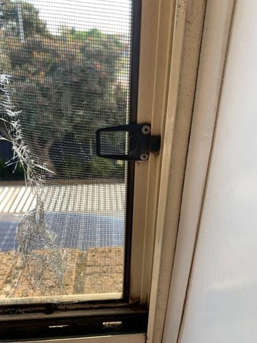

I need some advice on how to replace my fly screens. I have done this many times on other houses however this one has a pot riveted internal tabs that sits over the channel where the spine goes so I’m slightly at a loss. Other than drilling out the rivets, any suggestions? And if I drill them out can I reuse the same tabs or will I need to get new tabs?

Looks like the only option would be to drill out the pop rivets. It's a bit of an annoying design really, but you'll be able to reuse the tabs again, as it shouldn't damage them.

Thank you so much for your help. I ended up drilling out the pop rivets and replacing the fly screen successfully. As I had all the tools out and set up I ended up doing all the screens on the house all in one go (they were almost 20 years old and did look a bit weathered and tatty). Took all afternoon but they all look great, all clean and new. Amazing how much difference they can make.
