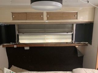

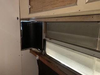

Thank you Eric, much appreciate the advice, will take photos and show the back of our caravan.IMG_0697.jpgIMG_0698.jpg

Thanks for the photos Tinytinhouse. Looks like you have an approx 1973 Viscount Royal there. I haven't done one of these myself but have seen a few other owners have issues with these. The winders often leak and because chipboard was used above and below, the damage looks worse than it is.  The sealant used had a life span of 10-15yrs, so well past "use by" if the windows haven't been resealed at all, the trims/j-rails should also be resealed, so leaking could be coming from anywhere.
Fortunately Viscounts had aluminium frames then so most of your water damage is cosmetic. If you're handy (and it's not really hard, just finicky and requires a lot of patience) check out Classic Caravans on Youtube, they have a few how-to videos. eg https://www.youtube.com/watch?v=ttFAAeuu1WY
There's a few schools of thought on best sealant to use, some swear by silicone, others prefer Sikaflex, others like in the video use Mastic. I usually paint after sealing so I avoid silicone (paint won't stick to it).  This topic has been the cause of many arguments in my caravan communities.
As for your doors. To remove the sliding doors, the tracks are usually just stapled in place, you can pry them off leaving just the cupboard frame in place. If you want hinged doors to replace, it would just be a matter of cutting ply (or your choice of material) to size, adding hinges, door knob and a catch to keep closed.
