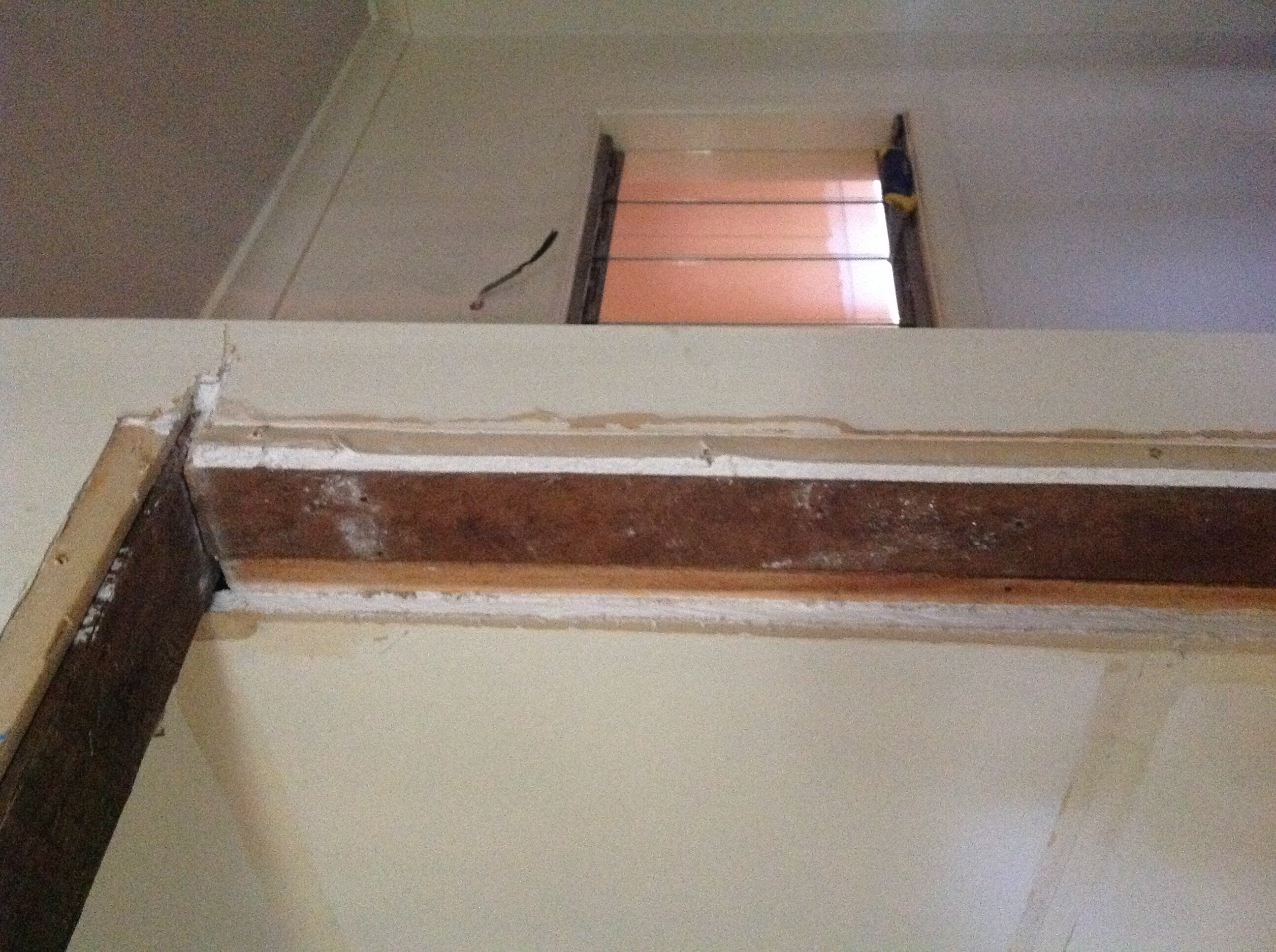

We are renovating and would like to remove a wall section that sticks out into a bedroom, however I don't know how to tell if the corner beam is load bearing or not. It certainly looks pretty solid (see photo), but from looking underneath the house, it doesn't seem to be resting on top of any beams beneath, just straight onto the floor boards.
Do I need to get an engineer in?

Having said this its a bit hard to tell from your photo? Basically the quality of the engineering/design advice that is given will be reflected by the quality of the information and photos that is provided. heres a fews tips
Provide a wide shot for perspective, close ups are great for details and rough sketches show hidden items and provide insight to what your are trying to achieve. This also assists others and becomes a valuable resource.Cheers

From your photo, I'm wondering if it's been transposed by 90degrees, going by what look like being the cornices on the lefthand side. It may also be helpful when you send @BIM_Engineer your next batch of photos, if you remove the drywall at/near beam intersections etc.

From your original post, "We are renovating and would like to remove a wall section that sticks out into a bedroom, however I don't know how to tell if the corner beam is load bearing or not. It certainly looks pretty solid (see photo), but from looking underneath the house, it doesn't seem to be resting on top of any beams beneath, just straight onto the floor boards."
To me, it's kinda weird to me that it'd being resting just on the floorboards, without any subfloor support.

@EarlAJ have they compensated with larger joists or closer bearers beneath in the floor under the wall and which way do the structural support members span..?
quote @BIM_Engineer:
"@EarlAJ have they compensated with larger joists or closer bearers beneath in the floor under the wall and which way do the structural support members span..?"
Very good points @BIM_Engineer, I'd hope that at the very least, the floorboard supports (structural support members) would run across the line of the wall in question, but that may kind of add doubt to whether it's a load bearing wall. ![]()
