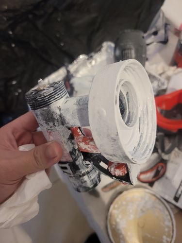

Any kind of liquid i can soak the sprayer in to dissolve all the dry paint residual?
Seems there are some residuals in the nozzle which makes the spray much weaker
Its not totally blocked though
We tried using hot water to clear it (but no improvement)
Also inspected other parts seems there are no blockage

Yes, its the ozito one, do we need to open this lid ? cant find any instruction in the manual to open this lid though

I don't think that lid is supposed to be taken off as there is no reference on the cleaning manual. If it is permanently attached do not use force to take it off. I suggest keep using warm-hot water to pump out the clogged paint channels in the sprayer. I don't recommend using chemicals as they will damage the interior mechanism of the sprayer.

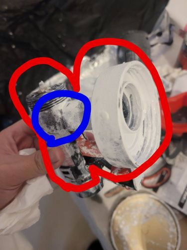

but we already sprayed it with a lot of soapy water, all visiable part, vents , filter and ports clear, just the nozzle part (in blue circle) is partly blocked and cannot be cleaned by needle or tiny brush
we are thinking to submerge the part (in red) in solvent ? like alcohol or ammonia.
but now hearing u said it might damage the sprayer, we cant make up our mind

As I have mentioned strong chemicals might damage the precise internal mechanism of the sprayer. I propose using thick fishing line to try and clean the nozzle of the sprayer.

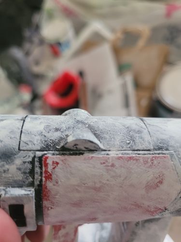

it seems ozito one doesnt allow us to dissemble the tip to clean the inner needle

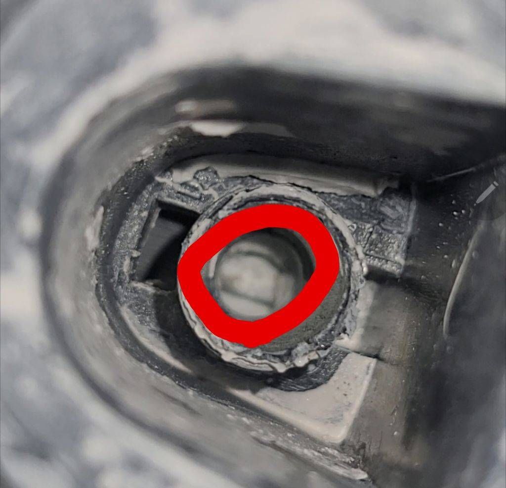

some dried paint in the vent
cant clear it with soap water or a brush, might need something stronger
