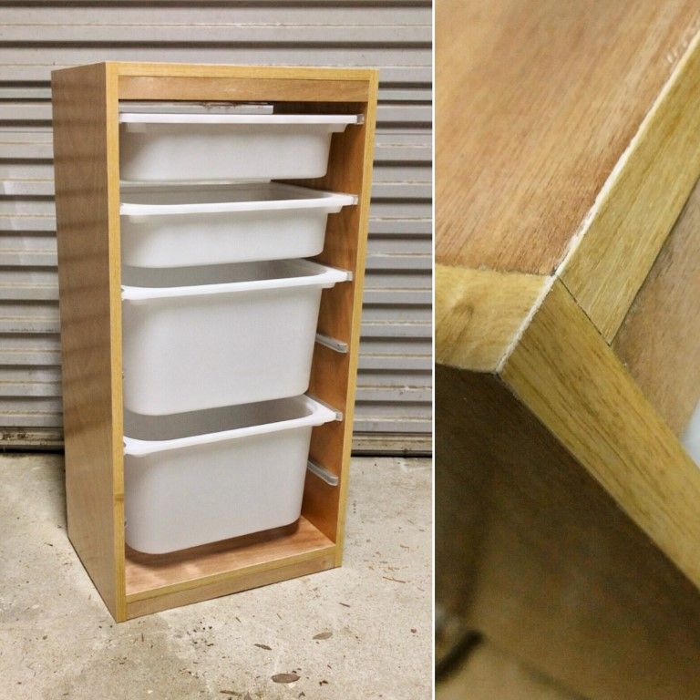

Initial assembly - loving pocket hole joinery!
Clear coat finished, starting on the table top
Dodgy edge banding
Dry fitting the bezel
Done and (ready to be chalk) dusted!
